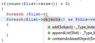

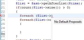

Hello, I believe that this should be a common problem but I couldn't find the solution. Let's suppose you have a class and than you go to add some code in it. While you are typing you get syntax error, so while you are typing you can't use auto complete (example a.jpg) . You can however still use auto complete in other lines (example b.jpg) .
This is a serious problem for me , because it forces me to do more moves (e.g. write the object in other line to have the auto complete , copy paste it in the right one and then delete it from the first). I am not sure if the fix has to do with auto complete (to work even if there are syntax errors while typing) , or with syntax errors check (not to check them while typing in order to have the auto complete option.

  • Attachment: a.jpg
    (Size: 6.98KB, Downloaded 382 times)
  • Attachment: b.jpg
    (Size: 6.37KB, Downloaded 400 times)
