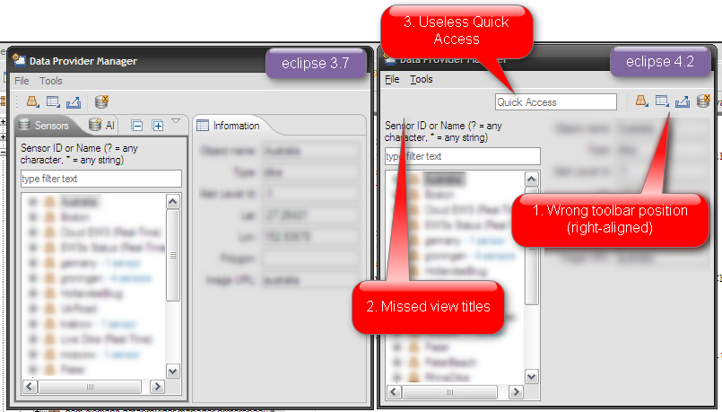

I just installed 4.2 and found 3 issues (see attached pic) with my simple RCP application:
index.php/fa/10566/0/
1. toolbar is right aligned
2. viewpart titles are missed
3. new 'quick access' field which is useless for me
On #3 seems like it is hard-coded somewhere and can't be removed, correct?
Any ideas about #1 & #2?
Thanks.
Re: RCP issues (view titles, toolbar, quick access) [message #893582 is a reply to message #893532] Wed, 04 July 2012 13:11 Go to previous messageGo to next message
#1 and #3 are known and we'll deal with them for 4.3.
#2 is bizarre: I've never seen anything like it. Are there any errors in your log? Are you using the old themes support? Can you reproduce with the RCP Mail example? If not, please file a bug report against Eclipse Platform UI and attach your .metadata/.plugins/org.eclipse.e4.workbench/workbench.xmi.

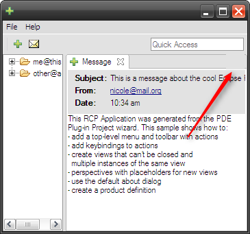

No, but mail example has another issue:
index.php/fa/10572/0/
Re: RCP issues (view titles, toolbar, quick access) [message #893692 is a reply to message #893582] Thu, 05 July 2012 05:47 Go to previous messageGo to next message
Brian de Alwis wrote on Wed, 04 July 2012 13:11
I just found the reason. These views are configured as standalone in the org.eclipse.ui.perspectiveExtensions. 3.7 shows titles for standalone views, 4.2 - doesn't.
