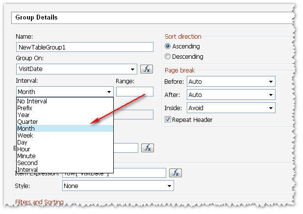

I have a table with a grouping
I want to be able to change the grouping interval of the table in script. See screenshot:
index.php/fa/10545/0/
I came across a code that does the similar work for charts, but i am having some problem for tables
var chart1 = this.getReportElement( "MyChart" )
catg = chart1.getCategory().getGrouping();
catg.setGroupUnit(params["paramTimeUnit"]);
Any kind help?
Thanks!
Karvesh

Look at beforeFactory script in attached example.
Jason
