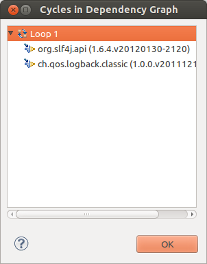

2 months later I'm finally have a time to try Logback from Orbit and
I've encountered a dependency cycle between org.slf4j.api and
ch.qos.logback.classis bundles.
Official p2 repo for Logback at http://logback.qos.ch/p2/ has same cycle
dependency between slf4j.api and ch.qos.logback.classis.
Is it a some necessity to OSGi-fy Logback? Should I just ignore it (and
allow for cycles during product export)?
Libor
