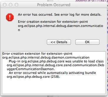

I work on Mac OSX Lion and ever since I've installed the Zend Debugger and gotten it to be able to debug php web applications, I often encounter this Eclipse startup error:
Error creation extension for extension-point org.eclipse.php.internal.debug.daemon.communication Plug-in org.eclipse.php.debug.core was unable to load class org.eclipse.php.internal.debug.core.zend.communication.DebuggerCommunicationDaemon. An error occurred while automatically activating bundle org.eclipse.php.debug.core (258).
index.php/fa/10481/0/

I had the same problem. My error log indicated that eclipse was having trouble setting a breakpoint in my PHP code. I had breakpoints set for PHP as well as java/android code. I removed all my breakpoints, restarted eclipse and the problem went away.
