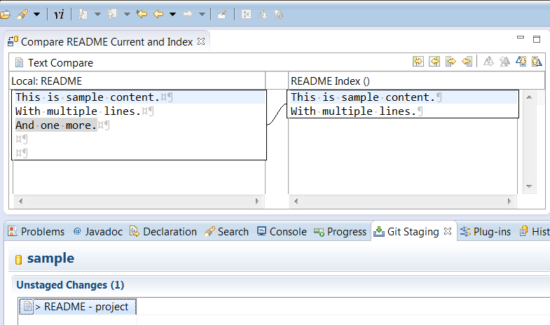

Yes, Eike and I have been investigating the state of our repos and
it appears that it's indeed the case that we have DOS endings in the
repo itself.  That leads to some of the problems we've been seeing
and we need to fix that.  This type of git bash script (without the
test flags) looks promising<br>
<blockquote>find * -type f -exec  dos2unix -b --test --verbose {} \;<br>
</blockquote>
We noticed too that files I commit with the latest git are properly
converted to Unix format in the repo.  So that's a big improvement
and we're very happy with that!<br>
<br>
With a clean repo (with proper line endings in the actual repo) we
still see a significant problem.   E.g., on Windows, if you clone
the repo for git://github.com/merks/sample.git, check out the
project, modify the README to add a line, and double click in the
staging view, you can see that all the lines are changed.  If you
turn on "Show Whitespace Characters", you can see that the working
copy has DOS endings but the file in the index it's being compared
against has Unix endings.  I would expect when autocrlf is true,
that the index file it's compared against  will also have been
converted.<br>

Yes, all the steps you describe work well with Indigo.  But your
steps didn't include what's not working well, i.e., double clicking
on the file in the staged view to see what the changes are.  That's
where the problem is: the tool shows the entire file as follows:<br>
<blockquote><img src="http://www.eclipse.org/forums/index.php?t=getfile&amp;id=10761" alt=""><br>
</blockquote>
See how the line endings are different and of course those are all
considered changes.  Naturally, if you need to merge when Egit
thinks the entire file is changed, that will work poorly too, so
just hitting the ignore white space button isn't a complete
workaround, though it certainly helps.<br>
