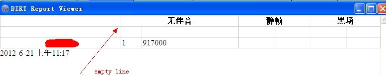

I'm using birt 2.3.x, and making a cross table, everything is OK but the result list show a empty line at the first line. How to hide this? Very Happy

Can you try using some crosstab script like described here:
http://birtworld.blogspot.com/2010/02/birt-crosstab-scripting.html
use the getCellId to check if you are on the right crosstab cell and
then use:
cellInst.getStyle().display = "none";
Jason

Thanks Very Happy
