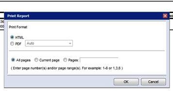

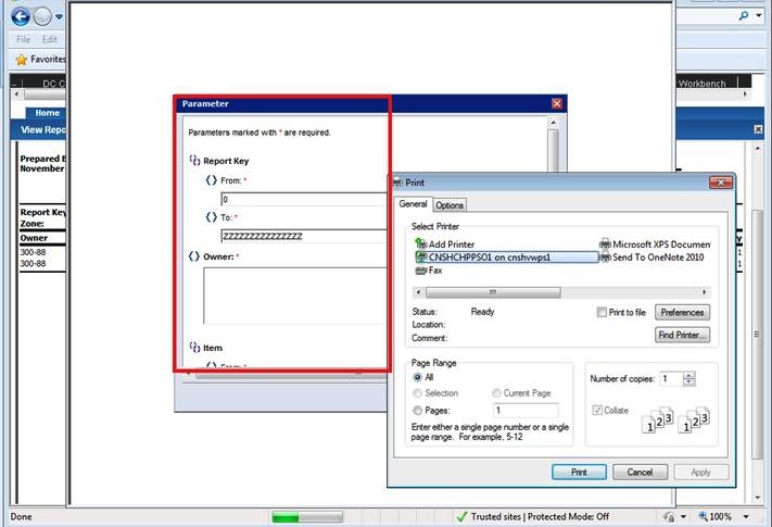

I'm having an issue where I'm being prompted for parameters again after
choosing Print Report from a report that is being displayed in the web
viewer.
The attached screenshots probably describe it better

Re: Being Prompted for Parameters Again After Choosing to Print [message #897168 is a reply to message #890026] Sun, 22 July 2012 18:09 Go to previous messageGo to next message
Hello friend.
Was smbp able to resolve this problem? I faced to the same.
My version is 2.6.1, but it doesn't matter I guess.
The window which appears has header PARAMETER SELECTION PAGE.
Also I've founded out that this problem appears just after DEPLOYING/RE-DEPLOYING the report, after a day or so on it disappears (probably any cash which is automatically cleans at 0-00 GMT? - it's just an idea).
If somebody has any comments - welcome.
Raishad, if you uploaded it into Bugzilla, give us a link please, cannot find.
