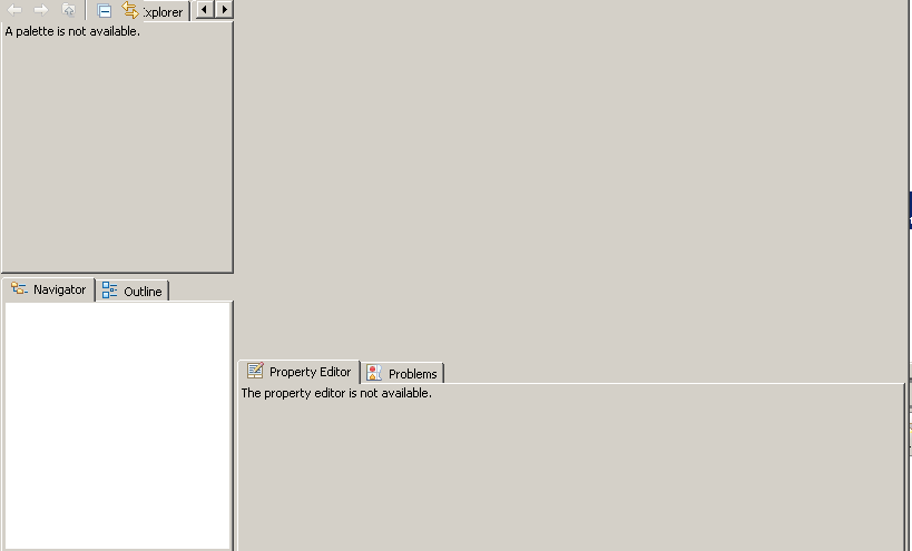

I have to integrate the birt-report-design perspective into our rcp-application.
I tried with:
PlatformUI.getWorkbench().openWorkbenchWindow(
"org.eclipse.birt.report.designer.ui.ReportPerspective",null);
But the workbench window which opens looks like in the attached image.
I thought i might have to provide a parameter so i tried to debug the opening of the birt-perspective when its running in eclipse, but didnt find the right place to start.
Do you have any idea what i did wrong?
Thanks in advance
