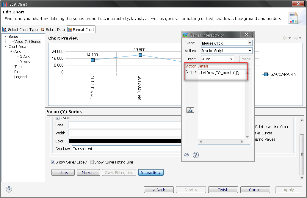

I am using PHP and Javabridge. I have a master report that can drill down to other reports. I have created the drill down by using the default BIRT MouseClick>Hyperlink and then Drill through options as shown in the screen shot a.png

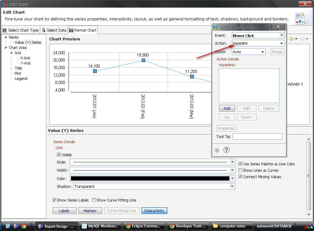

I want to be able to open the drill down report in another tab from my javascript library (dhtmlx). I thought of calling a javacript function instead of using the Hyperlink option (screen shot: 2.png).

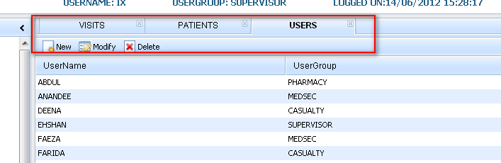

The function can thus create a new javascript tab (screen shot 3.png) and then call the php file with the parameters to create the drill down report.
index.php/fa/10299/0/
However, i cannot access the row["value"] of the series value clicked on. Can anyone propose me a better solution for that if any?

First off the setup looks really nice :> Take a look at this post:
http://birtworld.blogspot.com/2010/05/more-on-chart-interactivity.html
What you probably want is the valueData field.
Jason

Dear Jason,
Thanks a lot! It is working fine..
I had to do parent.MyJsFunction in order to get access to my function from my file..
Karvesh
