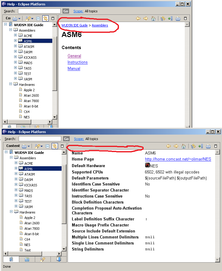

I have implemented an own AbstractTocProvider and a related IHelpContentProducer which reads contents from files or generates them dynamically. It all work fine, expect that I cannot find a way to keep the standard link navigation path in the content pane. Is there any re-use component/method/class/configuration to get it?

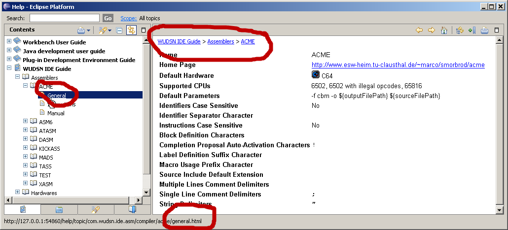

Found a way to achieve this by debugging the help plugin:
The URL path for the resource in the TOC/Topc for the resource to returned by the IHelpContentProducer must end with ".htm" or ".html", so the content type is detected correctly as "HTML". If this is the case, content filtes of the help applet will automaticaly add the navigation breadcrumbs.
