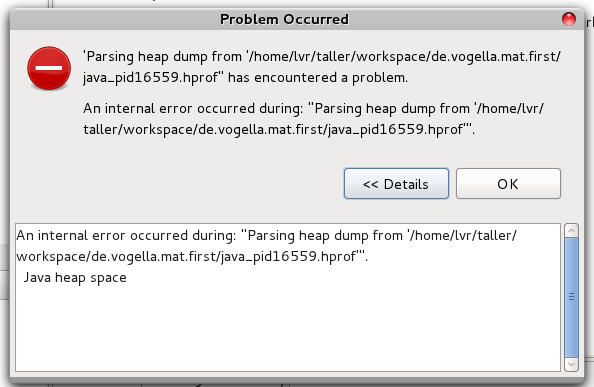

Hello, I'm in a big trouble: I need to run the MAT to debug an app. and no matter what I try with the simplest MAT example, the MAT always fails at 25% opening a hprof dump. The dump is not so heaavy - I think - just 665Mb.
My system:
Linux-amd64
Ram: 4Gb
Running: Just the MAT stand-alone and a couple of xterms.
Free memory before starting MAT: 3Gb
MAT run arguments (MemoryAnalyzer.ini):
-vmargs
-Xmx2g
-XX:-UseGCOverheadLimit
I began trying from Eclipse but, as it always failed at 25% while opening a *.hprof dump, I moved to stand alone version and same result.
Failure Log Message: See Picture Attached.

Never mind, with a clearer idea in mind, I just limited the -Xmx parameter to force the dump to be smaller .....as simple as that.
Now I'm at last able to test the MAT.
