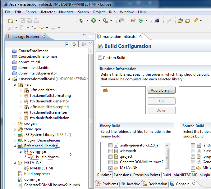

Re: Custom Types [message #884295 is a reply to message #883816] Sun, 10 June 2012 14:42 Go to previous messageGo to next message
And did you add the builtin lib to the classpath of the model file?
I think I did, but could you elaborate more on this step. Is the screen that?
  • Attachment: screen.png
    (Size: 87.04KB, Downloaded 144 times)
[Updated on: Sun, 10 June 2012 14:52] by Moderator
Re: Custom Types [message #884298 is a reply to message #884295] Sun, 10 June 2012 14:52 Go to previous messageGo to next message
just make sure the jar containing the builtin.mydsl is contained in the (java) classpath of the project the test.mydsl file is contained.
~Christian
