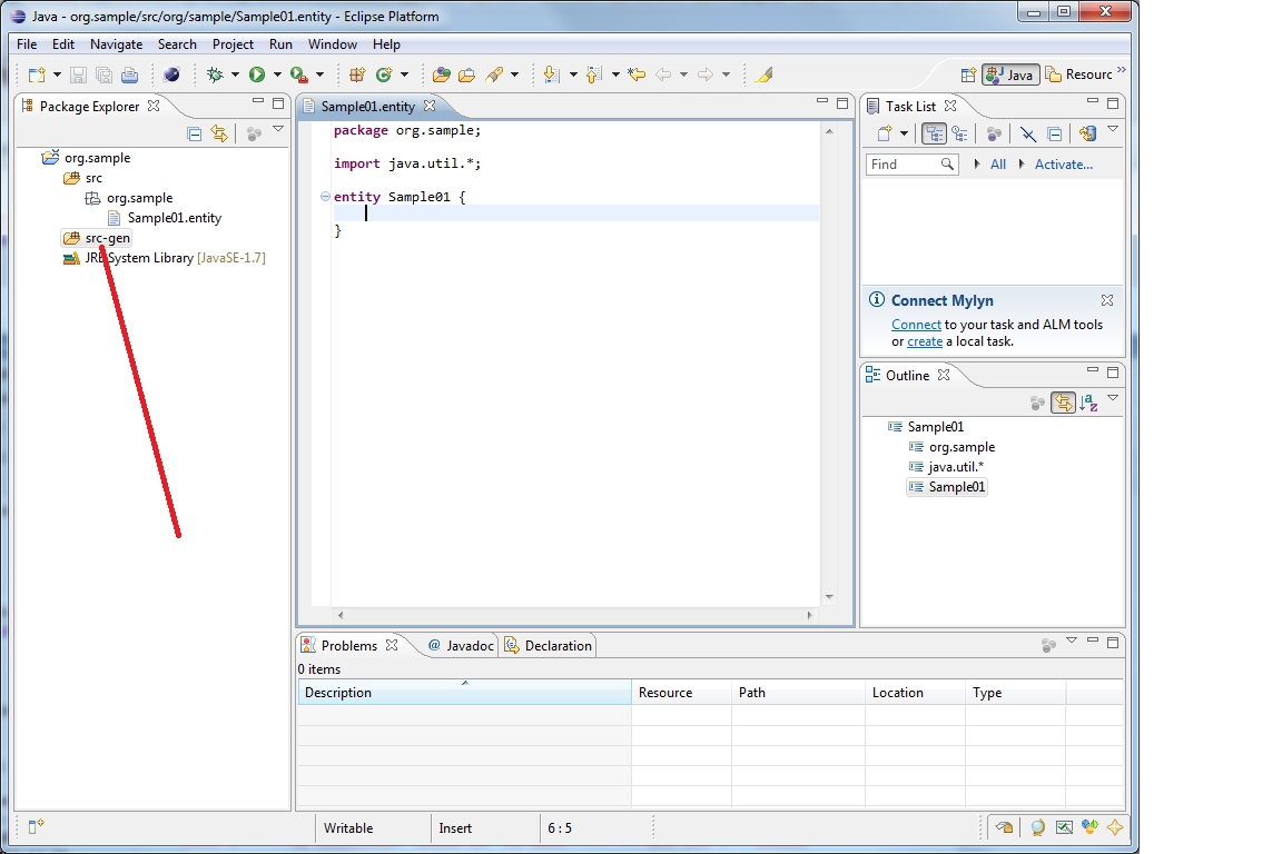

I have a grammar (Ytext based on Xbase) and a model.
In the model-File I can create my model
In the model I have created the folder src-gen.
My Problem is:
When I save my Modelfile, there is no java-File in the src-gen folder
I send you a picture of my model.

Re: Xtext: src-gen is empty [message #881255 is a reply to message #881243] Mon, 04 June 2012 04:20 Go to previous messageGo to next message
Van you post your jvmmodelinferrer
Re: Xtext: src-gen is empty [message #881257 is a reply to message #881255] Mon, 04 June 2012 04:30 Go to previous messageGo to next message
I get no jvmmodelinferrer.
When I save the file "Sample01.entity" then happens nothing.
The file is saved, thats all.
Re: Xtext: src-gen is empty [message #881263 is a reply to message #881257] Mon, 04 June 2012 04:43 Go to previous messageGo to next message
Hi a jvmmodelinferrer is a class in your run time project!
Re: Xtext: src-gen is empty [message #881276 is a reply to message #881263] Mon, 04 June 2012 05:11 Go to previous messageGo to next message
Thanks, now I have understand.
I have found the class.
Have a lot of thanks.
[Updated on: Mon, 04 June 2012 05:15] by Moderator
Re: Xtext: src-gen is empty [message #881283 is a reply to message #881276] Mon, 04 June 2012 05:22 Go to previous messageGo to next message
Hi please compare your projects with the one from the domain model
example. Especially the grammar and workflow
Re: Xtext: src-gen is empty [message #881292 is a reply to message #881283] Mon, 04 June 2012 05:45 Go to previous messageGo to next message
Step by Step I understand more
Smile

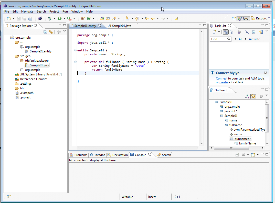

Re: Xtext: src-gen is empty [message #881431 is a reply to message #881292] Mon, 04 June 2012 10:48 Go to previous messageGo to next message
I have no solved the Problem.
But I have one more problem. The java-class is saved in the src-gen folder in the default-package.
What must I do, that it saved in the correct package in the src-gen folder

Re: Xtext: src-gen is empty [message #881452 is a reply to message #881431] Mon, 04 June 2012 11:25 Go to previous message
Hans-Georg,
you should start and write unit tests and learn more about EMF, Xtext
and debugging. Your grammar clearly separates packages by semicolon thus
the defined entity is not contained in something that has the name
org.sample.
Please be aware of the fact that most people in this forum do this in
their spare time. It's not often a good idea to throw screen shots,
complete model inferers and grammars into a question and let others do
your homework.
Sebastian
