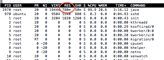

Error identification:
The attached file shows the command "top".
I have identified that the reserved memory performance increases every report. BIRT is not releasing memory.
  • Attachment: memory.png
    (Size: 27.36KB, Downloaded 410 times)
