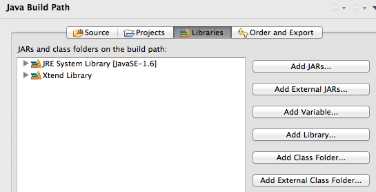

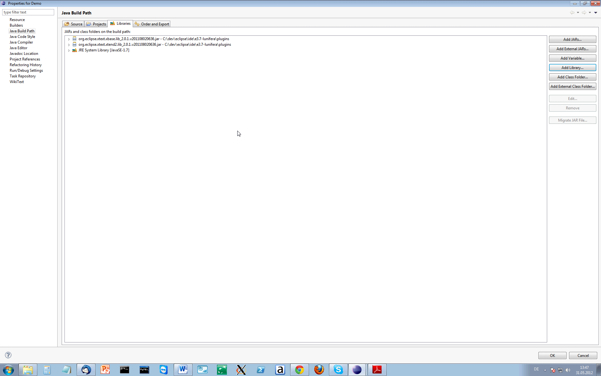

Re: Xtext: Xbase extensions [message #879456 is a reply to message #879454] Thu, 31 May 2012 05:02 Go to previous messageGo to next message
is the xbase.lib on the classpath of the project the model resides in?
~Christian
Re: Xtext: Xbase extensions [message #879462 is a reply to message #879454] Thu, 31 May 2012 05:13 Go to previous messageGo to next message
Hans-Georg,
please make sure that you put the Xbase library on the classpath of the
project that contains your sample file.
Sebastian

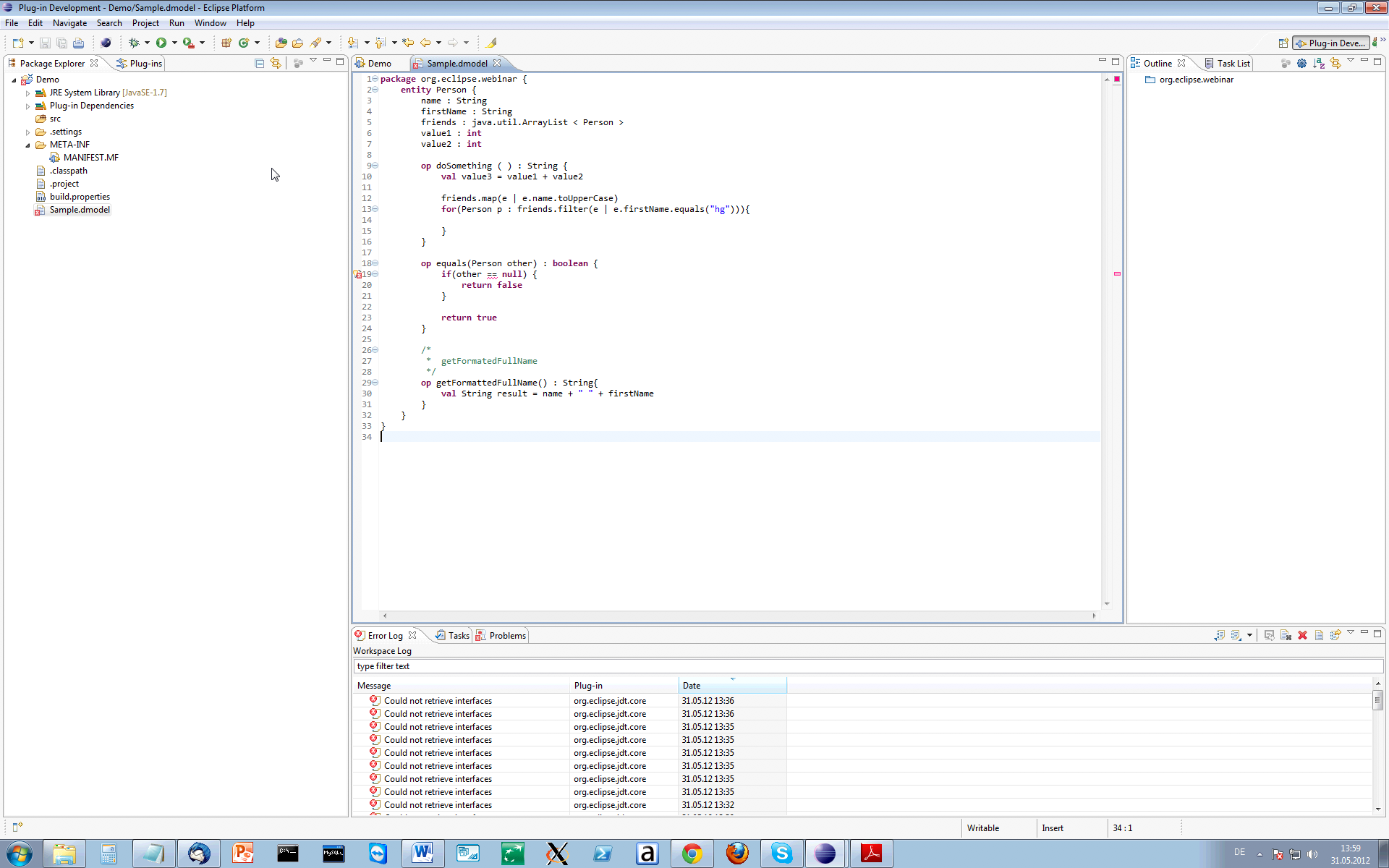

Re: Xtext: Xbase extensions [message #879477 is a reply to message #879462] Thu, 31 May 2012 05:46 Go to previous messageGo to next message
Thanks for your answer.
Now it works.
I have another Question
Question 1:
The following sourcesode is not working
		op equals(Person other) : boolean {
			if(other == null) {
				return false
			return true
Question 2:
How can I get Comment in the java-source-code
		// getformattedfullname
		op getFormattedFullName() : String{
			val String result = name + " " + firstName
the corresponding java-source-code is without comment
	public String getFormattedFullName() {
		String _operator_plus = StringExtensions.operator_plus(this.name, " ");
		String _operator_plus_1 = StringExtensions.operator_plus(_operator_plus, this.firstName);
		final String result = _operator_plus_1;
		return null;

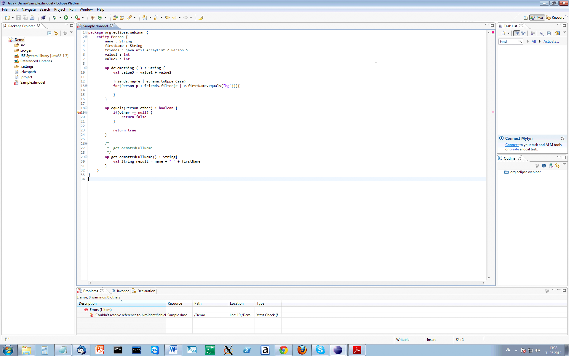

Re: Xtext: Xbase extensions [message #879494 is a reply to message #879484] Thu, 31 May 2012 06:10 Go to previous messageGo to next message
to (1)
I get the following jvmmodelinferrer:
Couldn't resolve reference to JvmIdentifiableElement '=='.
to (2)
with the following code I also don't get Comments in the corresponding java-source-code
		 * getFormatedFullName
multiline comments don't work

In the following I send you the Code of my model.
Very important for me is the error in
if(other == null) {
  return false

		value1 : int
		value2 : int
		op doSomething ( ) : String {
			val value3 = value1 + value2
			friends.map(e | e.name.toUpperCase)
			for(Person p : friends.filter(e | e.firstName.equals("hg"))){
			if(other == null) {
				return false
			return true
I get the following errors:

!ENTRY org.eclipse.jdt.core 4 4 2012-05-31 12:44:29.994
!MESSAGE Could not retrieve interfaces
!STACK 0
org.eclipse.jdt.internal.compiler.problem.AbortCompilation: Pb(324) The type com.google.common.base.Function cannot be resolved. It is indirectly referenced from required .class files

But if it needs to much time to solve it, plesae let it be.
You have helped me in further time so much so you have given a lot of to me.
I must not solve all the problems at once.
I can also look for this problem later.

Re: Xtext: Xbase extensions [message #879535 is a reply to message #879526] Thu, 31 May 2012 07:39 Go to previous messageGo to next message
I have created an Java-Project and added org.eclipse.xtext.xbase.lib_2.0.1.v201108020636
org.eclipse.xtext.xtend2.lib_2.0.1.v201108020636
I have the same error.
I send you attached the picture.
  • Attachment: Bild 1.png
    (Size: 326.28KB, Downloaded 284 times)
Re: Xtext: Xbase extensions [message #879537 is a reply to message #879535] Thu, 31 May 2012 07:44 Go to previous messageGo to next message
as i said, if you have a java project you should
(1) rightklick
(2) properties
(3) java build path
(4) add libary
(5) xtend libary

I have added the extend library. I hope it is correct so.
i send you a picture.
  • Attachment: Bild 2.png
    (Size: 212.91KB, Downloaded 312 times)
Re: Xtext: Xbase extensions [message #879543 is a reply to message #879539] Thu, 31 May 2012 07:54 Go to previous messageGo to next message
Yes and no,
yes you can it do this way but you have to add others (like guava too)
so why dont you simply use the predefined libary.
~Christian

I have now created an Plugin-Projekt an added the bundle
My MANIFEST.MF:
Manifest-Version: 1.0
Bundle-ManifestVersion: 2
Bundle-Name: Demo
Bundle-SymbolicName: Demo
Bundle-Version: 1.0.0.qualifier
Bundle-RequiredExecutionEnvironment: JavaSE-1.7
Require-Bundle: org.eclipse.xtext.xbase.lib;bundle-version="2.0.1"
I have added the picture of the plugin-project.
I don't understand what is wrong.
Another Question:
Where can i find the predefined library.
  • Attachment: Bild 3.png
    (Size: 347.63KB, Downloaded 307 times)
[Updated on: Thu, 31 May 2012 08:09] by Moderator
Re: Xtext: Xbase extensions [message #879551 is a reply to message #879548] Thu, 31 May 2012 08:12 Go to previous messageGo to next message
i guess you should update to Xtext 2.2.1 (see www.eclipse.org/Xtext for update site)
~Christian
Re: Xtext: Xbase extensions [message #879556 is a reply to message #879548] Thu, 31 May 2012 08:21 Go to previous messageGo to next message
You have to put the dmodel file into a source folder.
Sebastian
