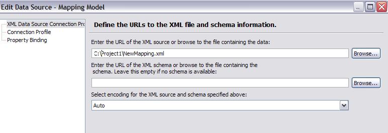

Hi Jason,
The source is a XML file.
Please have a look at the screen shot in attachment. Basically, I need to get "C:\Project1\NewMapping.xml" programmatically by using Java code.
Neil

Neil,
You can try something like this:
reportContext.getDesignHandle().getDataSources().get(0).getProperty("FILELIST");
But if the connection profile changes at runtime I am not sure this will
be updated. BTW the profile location property is:
OdaConnProfileStorePath
Jason
