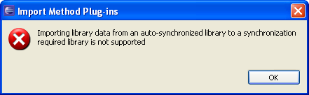

I followed the steps as described in <localhost>/help/topic/org.eclipse.epf.help.doc/topics/t_plugin_import.html.
In other words, I start with a new blank method library and attempt to import plugins provided by EPF 1.5.1.3_20111130.
Please see attached error message.
What am I missing here?

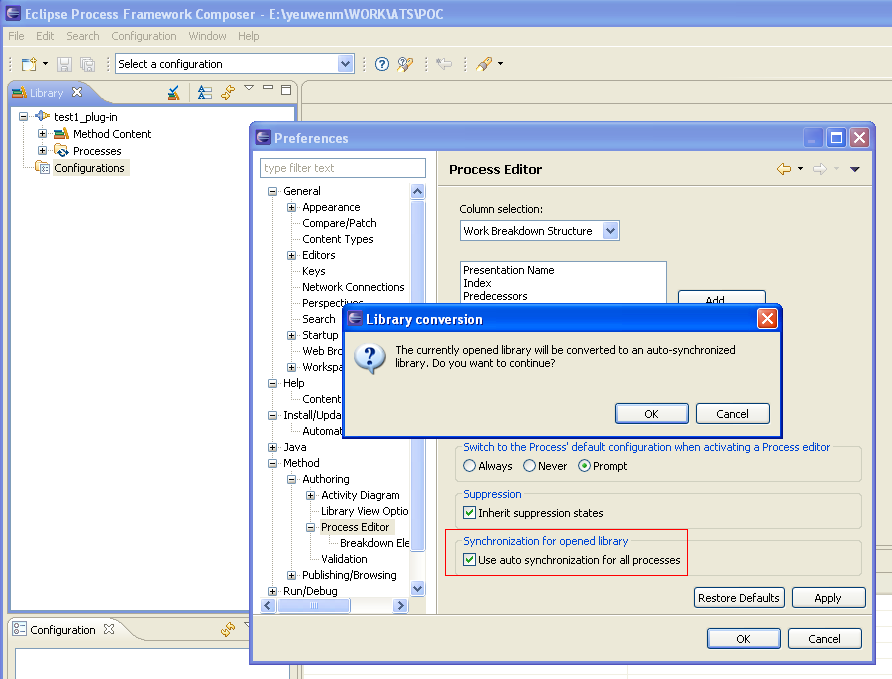

If I enable auto synchronization preference in EPF Composer as shown attached, I am able to import all EPL plugins.
