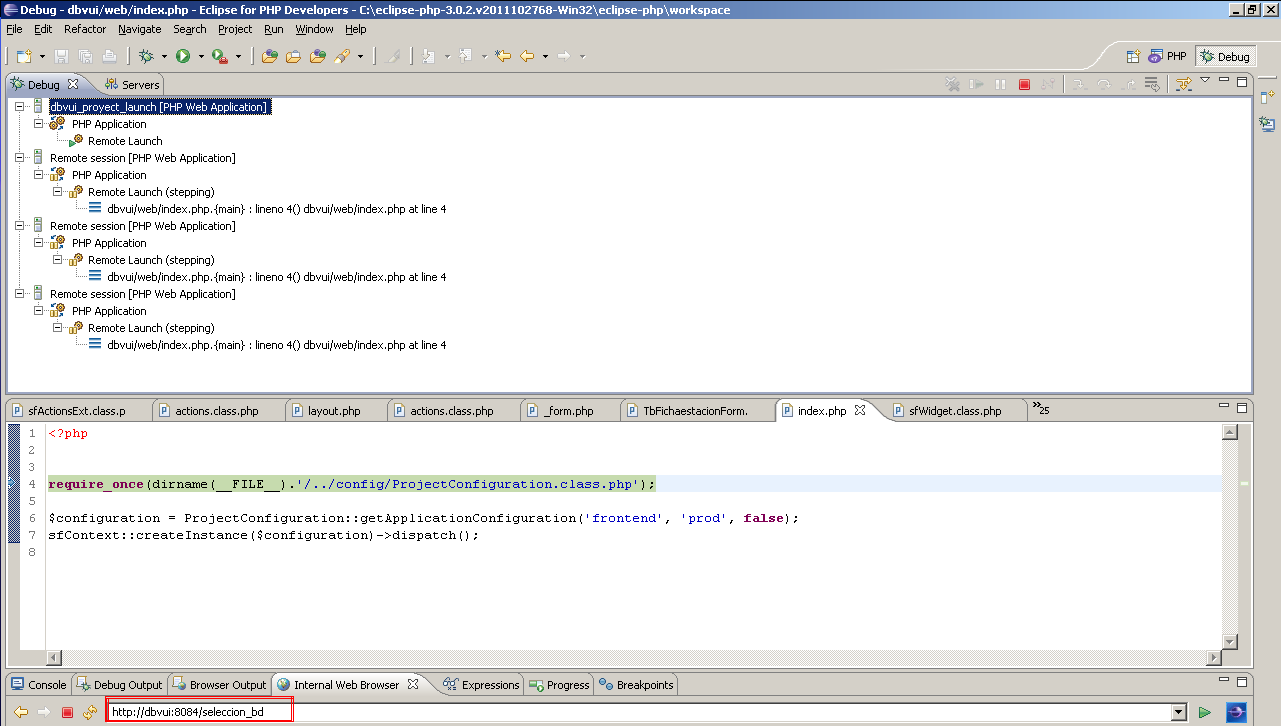

Hello, Im having an issue while debugging with Eclipse. Tested with xdebug but it probably happens with all types of debuggers.
Each time I forgot not to click in the address bar of the Internal Web Browser, If I go up with the mouse whell, it will automatically open a new debug session instance.
Its a real pain to debug with this issue since its constanly opening a new instance not only with the mouse whell, but with more options, and the worst of it is that I have to clean and end all of them and begin from the beggining with a new one because it goes crazy and I cannot get back to debug the original one.
Is it there a preference setting or php.ini parameter where I could limit to only one remote debug session?

Thanks in advance, attached a picture with the problem.
postimage.org/image/ombgnj6w3

Re: Eclipse opens multiple remote debug sessions - xdebug [message #878054 is a reply to message #878001] Mon, 28 May 2012 08:28 Go to previous messageGo to next message
You did enable "Accept remote session (JIT)", didn't you?
The behaviour is a result of that setting.
While you are debugging code, you're in unfinished session(the sequence of debugger communications), new url you made accidentally causes another debug session(debug target) and it will be accepted.
There is no option.(unless you'll disable "Accept remote session")(at least for now)

Hello Toshihiro Izumi, thanks for your answer. I was getting crazy trying to solve it and with that change seems to work.
In Preferences->PHP->Debug->Installed Debugger->Xdebug, Click Configure->Changed Accept remote session JIT from any to off.
I can debug to my localhost apache server without any problem with that setting changed.
Even with the setting changed, there seems to be still some issues with the whell while going up or down many times, the browser tries to go back to an URL and sometimes the session is lost as you have explained, but it works better now and doesnt open a new debug session Smile
It would be wonderfull if we could disable the mouse whell for the Eclipse Browser URL.
