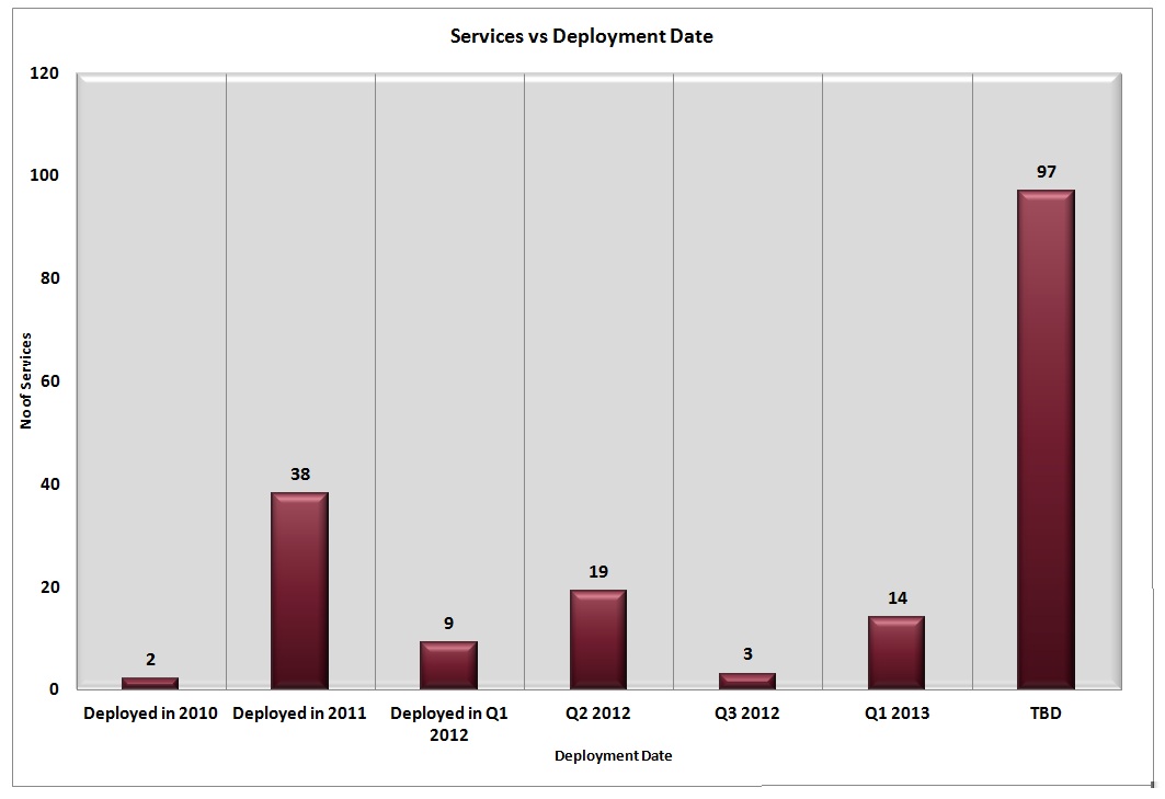

Thanks a ton. It was really helpful. Jason, can u please help me improve the logic further. Here if I have year is current year I need to show count in quarters and if YEAR IS prev year I need to show count for complete year.
If I want to show the values in chart, is there any alternative other than using script? Attached the sample screen shot, from excel report.
AR

you can add computed column to your dataset, something like:
if (   BirtDateTime.year(row["ORDERDATE"]) >= BirtDateTime.year(Now()))
	BirtDateTime.year(row["ORDERDATE"]) + "Q" + BirtDateTime.quarter(row["ORDERDATE"])
else
Then you can use such column in chart on X axis with enabled grouping, sorted by date field. Depending on your data source you should consider adding such column directly to you data (e.g. using SQL), before import to birt.
