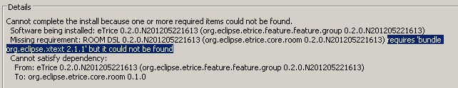

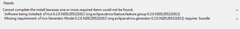

P.S.: I've uploaded the Eclipse Install Error Message below.

if you read the complete error message (the bottom lines were not contained in your screen shot, see attached one) you are told that Xtext 2.1.1 could not be resolved by the update manager.
To solve this issue you have to add the composite Xtext releases update site
http://download.eclipse.org/modeling/tmf/xtext/updates/composite/releases/
to your list of available sites.
You should also add
http://download.eclipse.org/graphiti/updates/0.8.2
Starting with a fresh Eclipse Modeling Tools package (Indigo 3.7.2, Windows 32bit) from
http://eclipse.org/downloads/
it worked for me.
Hope that helps,
Henrik
