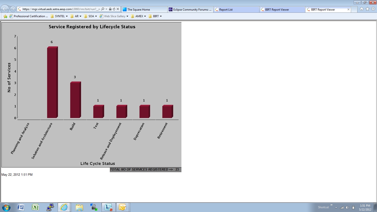

Re: Export feature in report [message #875489 is a reply to message #875380] Tue, 22 May 2012 16:52 Go to previous messageGo to next message
Hi Jason ,
Please find the attachment.
AR
Re: Export feature in report [message #875499 is a reply to message #875489] Tue, 22 May 2012 17:17 Go to previous messageGo to next message
What happens if you change the url by replacing the word run with frameset?
Or try leaving it with run and add &__format=pdf to the url. If the
format parameter is already in the url change its value to pdf.
Jason
