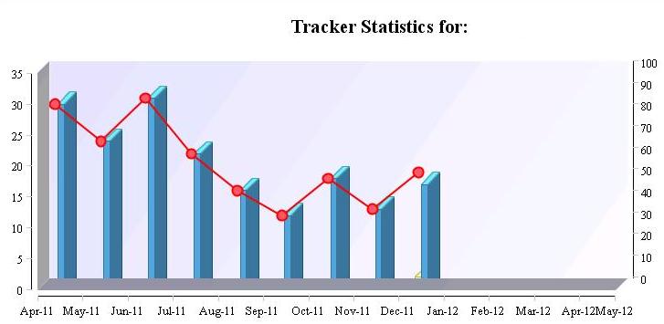

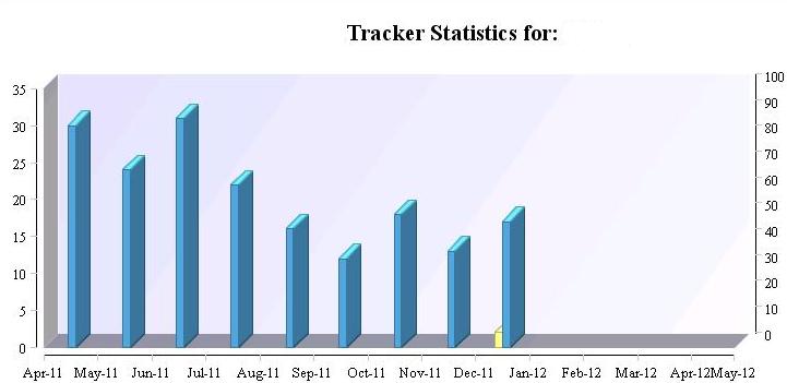

Hi, I've created a Two dimensional with depth chart with birt de 3.7.1 which contains 2 bar series (I've attached an example below: img.JPG). Here I've no problem.
But when I try to add a line series to the chart, I get a bad display: bar series cannot meet the X Primary Axis (See the second attached file bug.JPG)
Is that a bug or can I resolve it by a code??? (I'm using the design engine 3.7.1 to generate reports)

BTW Jason I'm facing two other problems in the two attached pictures of the first message (img.jpg / bug.jpg)
- Values of the X-Axis are not in the center of the bar chart
- there is a problem with the percent Axis (at the right of the picture), values doesn't reach 100% and stop at 90%. So is that a bug or am I having some mistakes in the code. You can see the same problem in the attached report in the last message and you have also the code.
I'm wating for your help please.

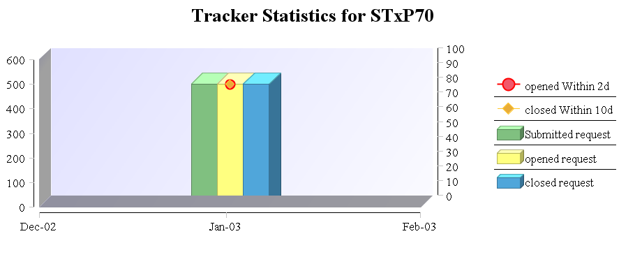

Claude
When I run your code I get the chart image that I have attached. Looks
a bit different than yours. BTW why are you setting the value of line
series 1 to row["PRODUCTCODE"]. Only linear/logarithmic data is allowed
here unless you put an aggr function on it, which yours does not. Can
you take the sample you sent me delete the chart and in the designer
create the chart you want, I will update your code to create that chart.
Jason

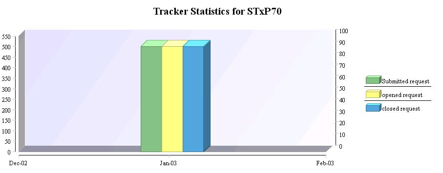

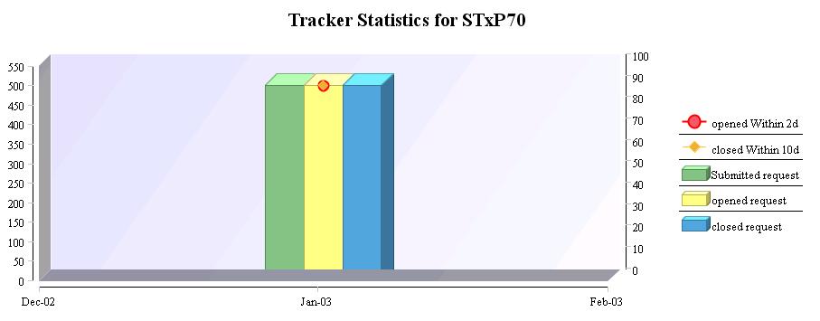

Re: Bug on the two dimensional with depth chart? [message #892606 is a reply to message #892537] Thu, 28 June 2012 13:16 Go to previous messageGo to next message
Jason,
I've created the first report that you can see in the first message using my internal SQL database that I can't share it with you so I tried to create another report using sample database and having the same problem as the first. I put useless data for that. In the two attached pictures you can see the difference and the bug (bar chart cannot reach the X Axis) is displayed in the first one "Test 1". Otherwise I get the bug when I add line series to existing bar series.
Do you have any idea about this issue??
