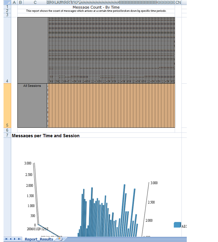

Here is a screenshot..
I'm using the native xls plugin for adding the image to xls.
The crosstab contains seconds in an hour so that columns cannot be reduced.
The crosstab is shown this way as it's limited by the page size. So I increased the page size, but that makes the chart stretch also..
If I add the chart in a new page this problem is fixed but I would need to runandrender again..
