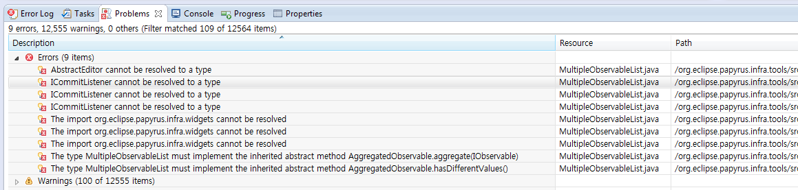

Just one file has all remained problems, that is org.eclipse.papyrus.infra.tools.databinding.MultipleObservableList.java.
That file has actually 3 errors.
#1. Dependency Cycle
MultipleObservableList.commit(AbstractEditor editor) needs AbstractEditor and ICommitListener of org.eclipse.papyrus.infra.widget plug-in, which leads to the Dependency Cycle between org.eclipse.papyrus.infra.tools and org.eclipse.papyrus.infra.widgets
#2. Import sentence is wrong
AggregatedObservable class is in org.eclipse.papyrus.infra.tools.databinding package,
not in org.eclipse.papyrus.infra.widgets.databinding as source says.
#3. Need to implement the inherited abstract method
Need to implement 2 abstract method aggregate(IObservable), hasDifferentValues()

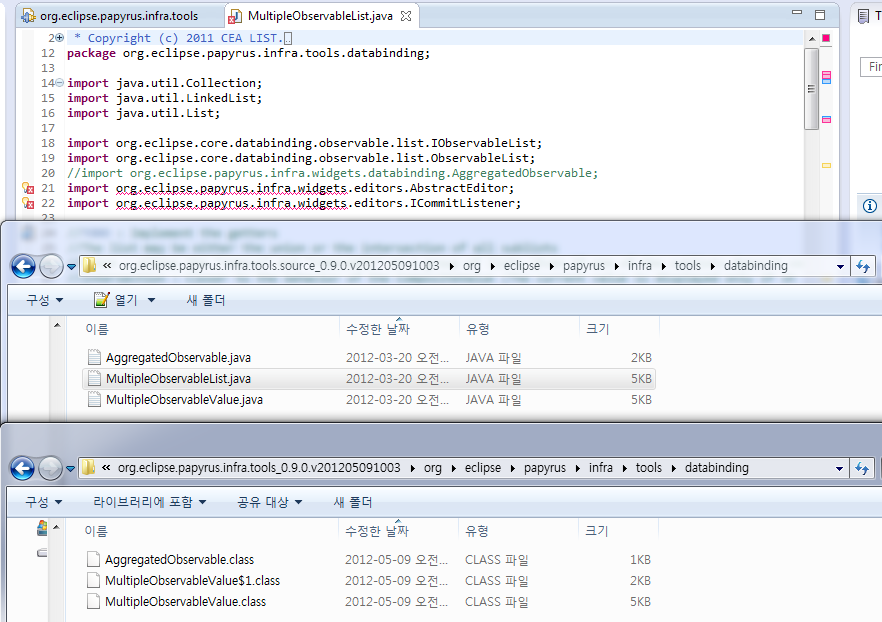

Thank you for the quick reply.
The attached file shows what I got from the official Papyrus download site - 'www.eclipse.org/downloads/download.php?file=/modeling/mdt/papyrus/downloads/drops/0.9.0/S201205090534/Papyrus-Update-0.9.0_M7.zip'
index.php/fa/9739/0/
The top picture of Eclipse Editor shows the source of org.eclipse.papyrus.infra.tools.databinding.MultipleObservableList.java.
Line 20 to 22 shows it depends on infra.widgets.
(I just made single line comment on line 20 because 'AggregatedObservable' is not of org.eclipse.papyrus.infra.widgets.databinding as the source says,
but of org.eclipse.papyrus.infra.tools.databinding, actually.)
The middle picture of Windows Explorer shows the contents of infra.tools.source.jar.
You can see MultipleObservableList.java which is not shown in the bottom picture showing the contents of infra.tools class jar.
As you can see, the source jar doesn't seem to match well with class jar.
If your reply is right, then the released source jar may be wrong.

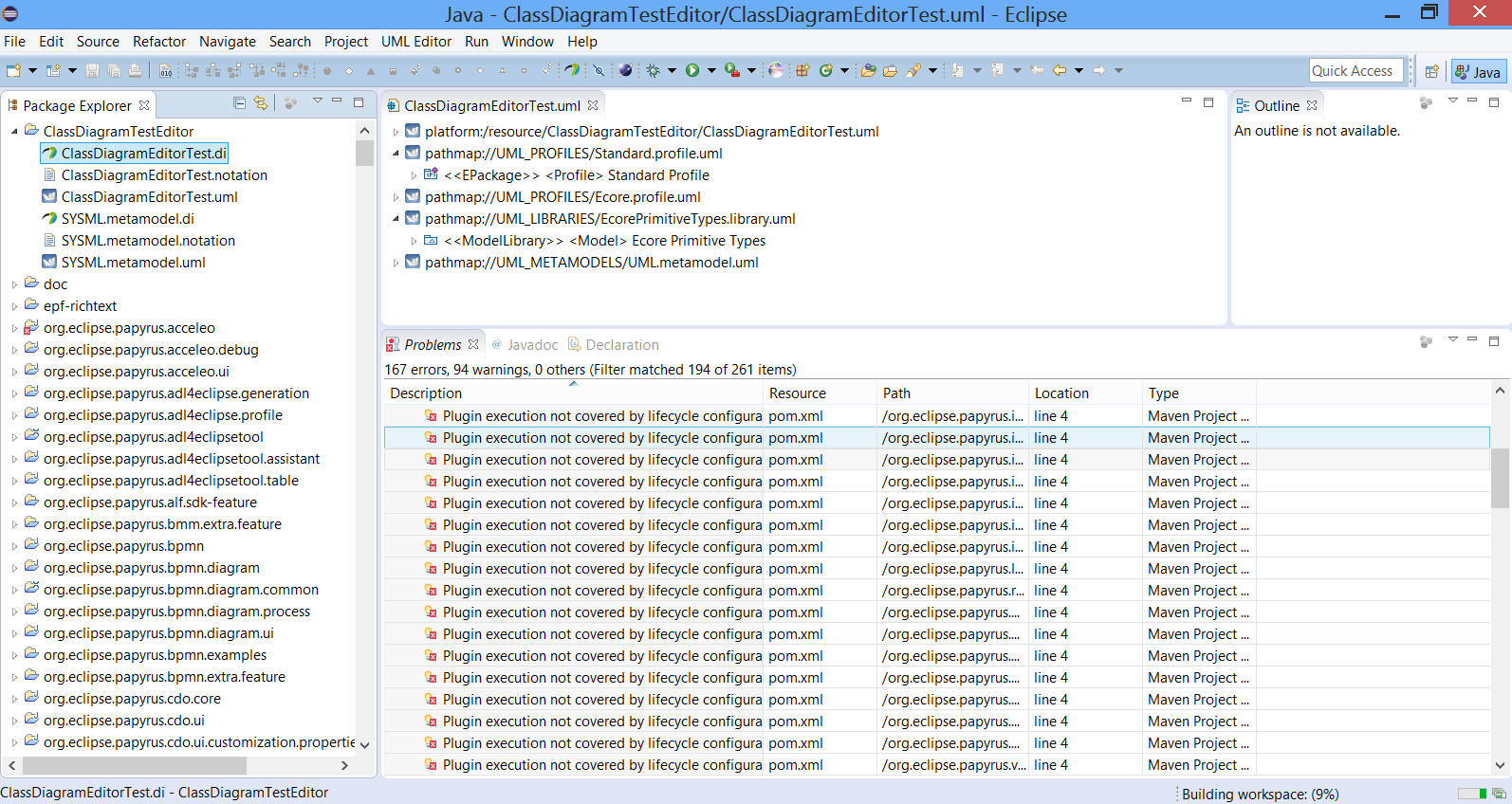

hi ;
Thank you for the reply.
i try to run papyrus code but i receive this problems (papyruserrorr.PNG)
regards
