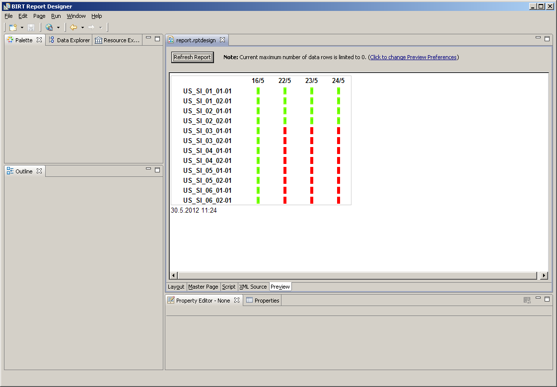

Thanks for answering. I add an example and a picture. For a better understanding of the picture: SI 06-02-01 is the test case based on the sample data. Every green dot or red cross represents a test run of this test case every day (via CI). SI 06-01-01 contains fictional values if I have a lot of changes and daily runs.

Ok, now I see Smile I don't think you can create such chart. However, you can consider using a crosstab. I'm attaching sample report, data and screenshot. I changed your data - coded success as 1 and failure as 0. Then you can create simple crosstab, add highlights and tweak formatting a little.

Hi Tomas,
thank you for your help, I think this will do the job.
