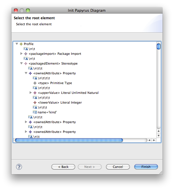

I try to use the SPEM profile from the OMG into Papyrus, but I don't see the way to do this.
Here are the steps I follow, based on this topic :
1) I download the SPEM profile and rename into "spem.profile.uml"
2) I right-click on the profile and select new/papyrus model
Default name proposed by papyrus is "spem.di" so I have an error message to advise me to use the same name as domain model file name (spem.profile.di)
3) I rename the file "spem.profile.di" so as to move on the next stage
4) I check the Profile radio button in the "Select language of the diagram" page
5) I check the checkbox "UML Profile Diagram" so as to create a UML Profile Diagram once the wizard is finished. I don't know why, but in this case I can't create new UML Profile Diagram from the right-click inside the Model Explorer
6) The last page lets me select the root element. There is a bug on the labels (see Figure below)
7) Finally, I click on the Finish button and nothing is being done.
Is there any way to use the SPEM profile inside Papyrus ?
I use Papyrus 0.8.2 on Eclipse Indigo Service Release 1.
Thank you,
regards,
Nicolas

Your SPEM file uses "http://schema.omg.org/spec/UML/2.1.1" which is an
OMG nsURI recognised by MDT/UML2. But:
When using OMG nsURIs, you must use *.xmi rather than *.uml extensions
unless you take care to revise the content registrations.
Similarly, when using MDT/UML2 nsURIs, you must use *.uml rather than
*.xmi extensions.
When having trouble with models, don't try to user advanced modeling
tools until your files load successfully in the Sample Ecore Editor or
UML Model Editor.
Ed Willink
