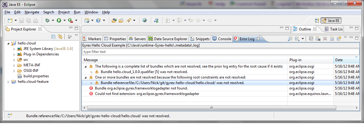

I installed Gyrex 1.0 and Hello Cloud Example from git. When I try to run using provided launch environment, I am getting Bundle org.eclipse.gyrex.frameworklogadapter not found error and a bunch of exceptions.
What am I missing?

Am 16.05.2012 16:58, schrieb Nicholas Dickey:
Did you setup Gyrex using a Target Platform? Can you post a screenshot
of your target platform?
> What am I missing?
I think that's a bug in the "Example" launch configuration. I just
pushed a fix which removes the 'org.eclipse.gyrex.frameworklogadapter'
argument from the VM arguments list. It's used in development to enable
capturing of framework events outputted by the OSGi framework into SLF4J
log. But this requires the 'org.eclipse.gyrex.frameworklogadapter' to be
in the same folder as the 'org.eclipse.osgi' bundle. Somehow that's not
the case in your setup. That's why I asked for a screenshot of the
Target Platform.
