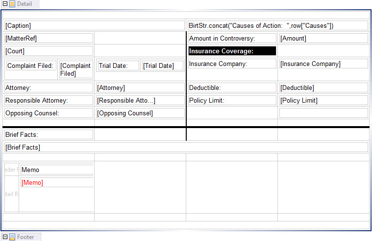

Grid should work to. I think the issue is that it is in the footer of
the list. Look at the attached example.
Jason
On 5/10/2012 4:20 PM, Jeff Stouse wrote:
> When I make a copy and delete everything from the page and then drag the master table to the layout screen, I get a table. My original report is based on a grid. the Report works when I drag the detail table into the second column, but not in my original report when I have a grid.
> I was following the Field Guide (I purchased the book) on setting up the master-detail type of report - so it doesn't work if you use a grid -but does if you use two tables (one for the master and one for the detail)?
> So I should re-create this using the two-table approach, with the master table having the detail table in one of its detail rows?
> I've uploaded two screen shots of my original report:
> 1 - No detail rows in grid
> 2 - Displaying detail rows in grid
> According to those views - my detail table is in the detail rows of the grid.
> Still confused, but I think I have a way to fix this - just re-create using two tables - right?
> Thanks,
Jason
> Thanks,
