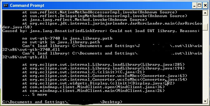

I have a bit of a strange issue. I am developing an application using the WindowBuilder and associated libraries. The program works great on my 32-bit Linux box that I have been developing on. However I have two issues.
1) When running the jar on a 64-bit machine, it fails, which makes sense because I packaged the 32-bit libraries in the jar. If someone knows how to make the jar dual architecture, help would be greatly appreciated.
2) More importantly (as my client is chiefly 32-bit Windows XP as most of the world is) I can't run it on Windows. I actually moved the project over to a windows box, set up the WindowBuilder libraries in Eclipse, and recompiled, and it did work. However when I try to use my jar created in Linux, it fails with a message that I will attach (something about needing swt_gtk libraries). Now I'm somewhat new with java, but isn't the goal interoperability? I just find it strange that WindowBuilder seems to be using platform specific code. That being said, any ways around this (ways to make the program work on multiple operating systems) would be fantastic.

On another note, I realized I blanked my name out on the screenshot for objectivity, and my name is on the thread. hahaha oh well.....

Sorry, but this does not sound like a WindowBuilder question. WB generates generic Eclipse/SWT code that will run on any supported platform. There are lots of ways to package the generated code (SWT app, RCP app, Eclipse plugins, etc.). Questions about how to build and deploy SWT applications should be posted to the Eclipse SWT forum. WB is not "using platform specific code" in this context, but SWT certainly is, and you will need to package the appropriate SWT libraries with your app in order to run it on multiple operating systems (32-bit, 64-bit, Windows, Linux, etc.).

Yes. You should report to the Eclipse SWT forum and explain that you are trying to package an SWT application.
