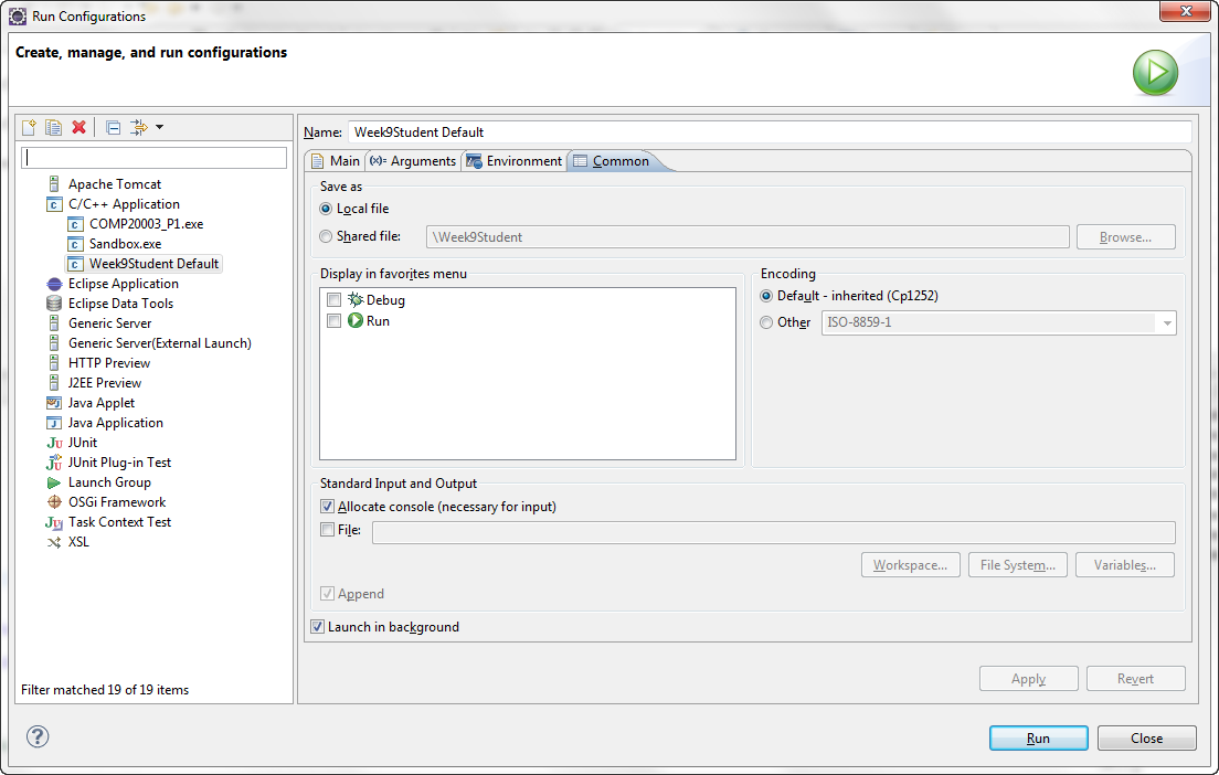

Ahh! Okay, now I know the term. Yeah, basically what I want is to redirect my input to my testfile somehow.
I tried going to that Common tab you suggested, but I can't seem to find anything related to redirecting input. If there's anything being redirected, it's the output instead! I tried linking my file to the "File:" field, but the output is written there, instead of being read.
Or am I opening the wrong option...?
index.php/fa/9504/0/
If not, how do I do that? Sorry, I'll try to keep up with learning about those things, but I'm getting crammed with my other uni assignments :/
