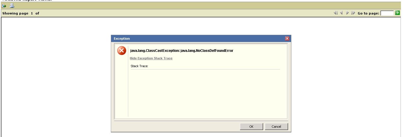

Unable to run Chart Report with CrossTabs using BIRT 2.6.2 [message #869542] Thu, 03 May 2012 10:55 Go to next message
Received java.lang.ClassCastException: java.lang.NoClassDefFoundError exception in runtime when tried to run a Chart Report with crosstabs in BIRT 2.6.2. However the Exception Stack Trace is not getting printed at all.
The <param-name>BIRT_VIEWER_LOG_LEVEL</param-name> in BirtReports/WEB-INF is also to 'FINEST', but still no exception details printed. Error screenshot attached.
How can we get to the exception stack trace printed to identify the root cause?
Environment Details:
Websphere - 6.1.0.39
JDK - 1.5.0_28
Host OS - SunOS, v5.10

Re: Unable to run Chart Report with CrossTabs using BIRT 2.6.2 [message #869922 is a reply to message #869883] Fri, 04 May 2012 16:02 Go to previous messageGo to next message
The same report runs successfully when the Chart section is removed.
Is there chance that we could have the complete Exception printed in the log?

Re: Unable to run Chart Report with CrossTabs using BIRT 2.6.2 [message #870567 is a reply to message #870306] Tue, 08 May 2012 14:59 Go to previous messageGo to next message
No, this is the first and the only report that has chart included. No exception stack trace found in the log with respect to this event.
