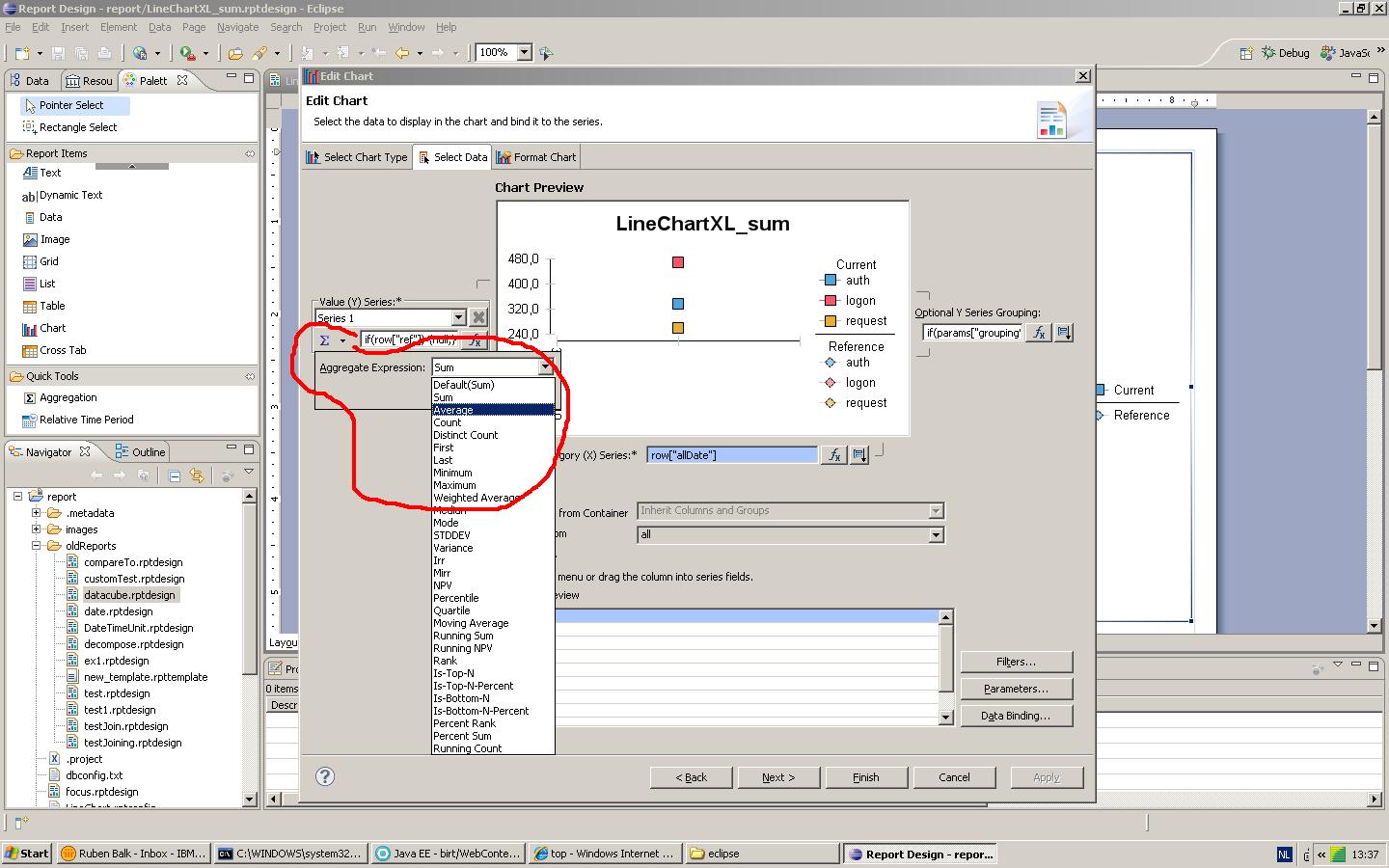

I have trouble finding the right handles to change the aggregate expression of some line series based on a report paramter. Especially because content assist doesn't pop up.

However, don't want to change the category axis, but the y axis. I'm unable to get to the right object to call setAggregateExpression. According to the API I should get to the SeriesGrouping object.

Re: Changing aggregate expression of chart series based on report parameter [message #869875 is a reply to message #869786] Fri, 04 May 2012 11:28 Go to previous messageGo to next message
Ruben
Have a look at the attached image. Tell me which one are you trying to
change.
Jason

Re: Changing aggregate expression of chart series based on report parameter [message #870444 is a reply to message #869875] Tue, 08 May 2012 05:30 Go to previous messageGo to next message
Hey Jason,
The seriesgrouping on the Y series definition

Ruben
Take a look at :
http://www.birt-exchange.org/org/devshare/designing-birt-reports/1508-change-aggregate-function-on-chart-series/
Jason
