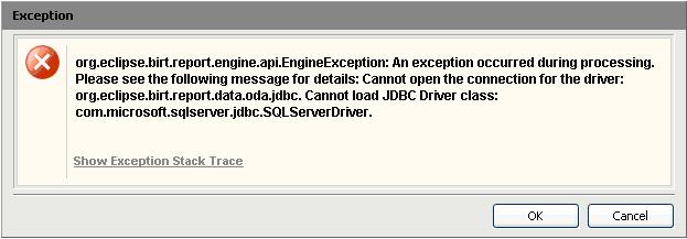

Our developer has another reporting issue that I need solved as soon as possible. I have a report in BIRT 2.5 that will not run in the TIP. This is due to a JDBC error. I have done two things that may have caused this:
1) I have pointed the report designer "resources" at the following folder: <\\metisentrep\east\Troux Architect Files\BIRT\03 Report Resources and Report Libraries\>. (Window-->Preferences-->Report Design-->Resource). I have images and master pages ect stored in this folder that is used in generation of my report.
2) I have renamed the troux_core.library to troux_core_2_5.library and used this in the report. This is also stored within the above folder.
The report runs fine from BIRT. Obviously something in the report itself, or the TIP is not pointing to the correct resources, or my renaming the troux library has broken something.
I have a suspicion that because the TIP is in a lower lever network domain, its on a different server with different credentials, it can't authenicate to the production network domain where the report is being run from e.g. the metisentrep server is in the production domain.
Attached is the error message
Can you investigate?
Re: Report Error when generating [message #857646 is a reply to message #856982] Thu, 26 April 2012 14:36 Go to previous message
The error does not look like it has anything to do with resource folder
but possibly not locating the jdbc driver in the drivers directory of
the jdbc plugin in your deployed env,
Jason
On 4/26/2012 2:20 AM, Mitchell Bevan wrote:
> Hi,
> 1) I have pointed the report designer "resources" at the following folder:<\\metisentrep\east\Troux Architect Files\BIRT\03 Report Resources and Report Libraries\>. (Window-->Preferences-->Report Design-->Resource). I have images and master pages ect stored in this folder that is used in generation of my report.
