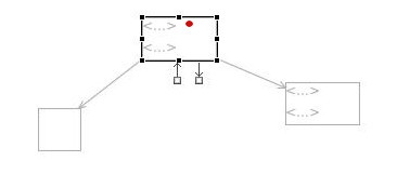

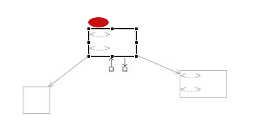

Hello Ralph,
It doesn't really matter,
It can be inside the selection
index.php/fa/8035/0/
Or even outside
index.php/fa/8036/0/
If it's inside, I'd like it to be positioned on the "top-left" corner instead of just the top (like the image).
Anyways, as I said before, as long as it's visible and clickable it's OK Smile
