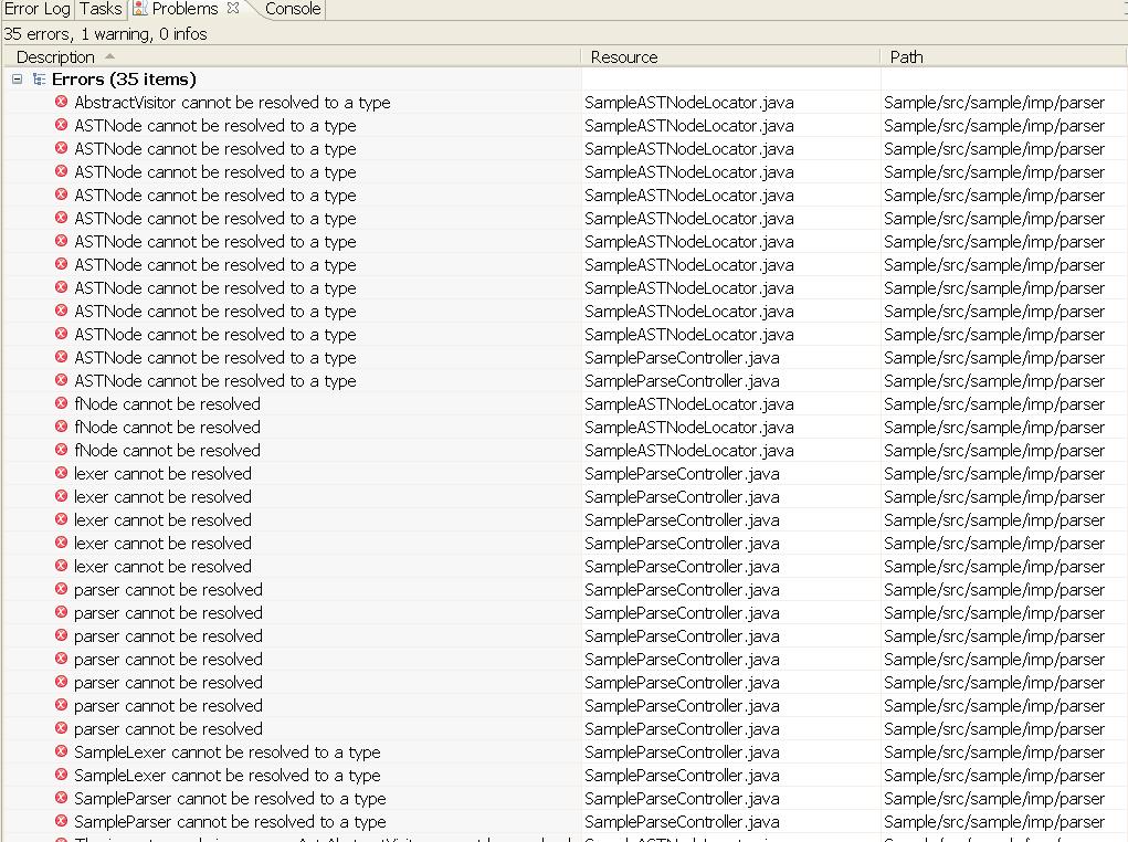

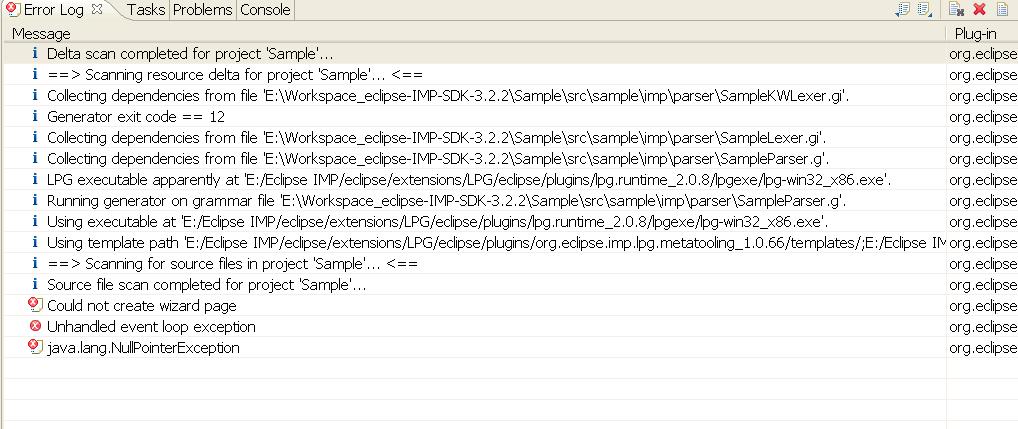

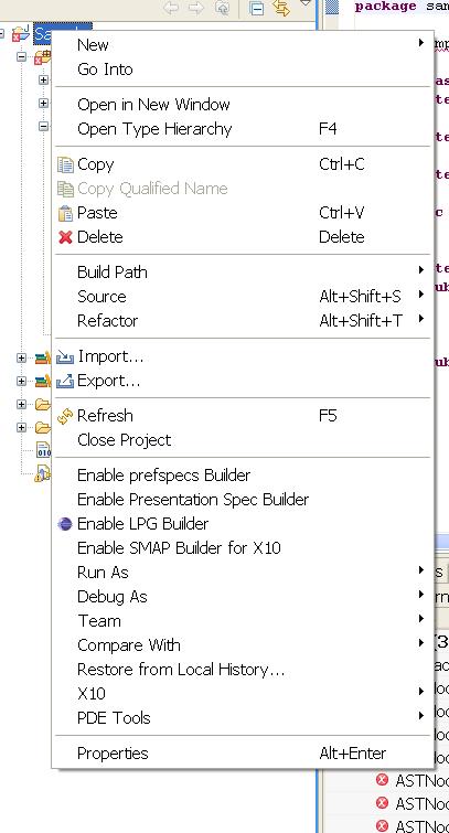

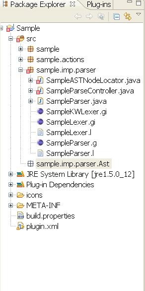

Originally posted by: hiteshn.mail.gmail.com
Hi Stanley,
Yes, LPG Runtime feature is installed, version 2.0.8.
I created a plug-in project named "Sample". When I used the option "New LPG
Grammar with Parser Wrapper", two packages,
(1) sample.imp.parser
(2) sample.imp.parser.AST are created.
Package 1 has following files:
SampleASTNodeLocator.java
SampleParseController.java
SampleParser.java
SampleKWLexer.gi
SampleLexer.gi
SampleLexer.l
SampleParser.g
SampleParser.l
But package 2 is completely empty... (no classe/interfaces in it) and
because of this I get errors in SampleASTNodeLocator & SampleParseController
files saying "ASTNode cannot be resolved to a type".
The SampleASTNodeLocator & SampleParseController files use "import
sample.imp.parser.Ast.ASTNode"...
Also, how do I check if LPG builder is running or not?
Hitesh...

If the LPG Runtime feature is installed, then the LPG builder should be
available through that. If it were running successfully, there should
be another 8 or 9 Java classes in sample.imp.parser, and you should have
a set of AST classes in the *.AST package (and a few other classes). If
it were running unsuccessfully then you might see an exception stack
trace or error message on the console or you might get an error message
in the Error Log view. Do you see either of these things?
Another thing to look at: If LPG is installed properly, and you right
click on the project Sample (or any other one, for that matter), you
should see a menu item "Enable LPG Builder." (If the rest of SAFARI is
installed properly, you should see some other "Enable *** Builder"
items, as well, such as "Enable X10 Builder.") If LPG is properly
installed then you should see the corresponding menu item. If you don't
then that's a problem.
Of course, if the LPG builder is properly installed, it should be
running automatically and you should see the additional classes that I
mentioned above. I just tried this with the current IMP release on SF
and using your names of "Sample" and "sample" for the project and
language, and it worked for me. If you don't see the additional classes
but you do have the "Enable LPG Builder" menu item, then you could try
selecting that so as to manually enable the builder. That shouldn't be
necessary, but see if it has some effect.

> Hi Stanley,
> SampleParser.java
> SampleKWLexer.gi
> SampleLexer.gi
> SampleLexer.l
> SampleParser.g
> SampleParser.l

I have the same problem. It may be of help to notice that sometimes the
exception below appears in the console. In the wizard, the fields at the
bottom are disabled and there's a message "can't create wizard page".
best regards,
Vlad
"New
> LPG
> > > SampleParser.java
> > > SampleKWLexer.gi
> > > SampleLexer.gi
> > > SampleLexer.l
> > > SampleParser.g
> > > SampleParser.l
> best regards,
> Vlad
> !ENTRY org.eclipse.imp.runtime 4 0 2007-10-19 14:06:13.687
> !MESSAGE Could not create wizard page
1)Stanley, thanks a lot for the mails and help.
2)No, i don't see any other Java classes other than what I had mentioned
earlier. (*.AST is completely empty) I have attached the snap shot of my
project exlporer, this should show you what files are generated in the
packages. Alao, attached are the error log & problem views...
3)Yup, I can see "Enable LPG builder" menu item along with others...
4)I tried doing by even selecting the "Enable LPG builder" manually but
still dont have any luck going my way :(
Hitesh...
>> LPG
>> SampleParser.java
>> SampleKWLexer.gi
>> SampleLexer.gi
>> SampleLexer.l
>> SampleParser.g
>> SampleParser.l

"Vlad D." <vladdu55@gmail.com> wrote in message
news:ffa7nj$pga$1@build.eclipse.org...
> Oh, I see now that all IMP features have been installed outside of the
main
> Eclipse installation (I have some external product extension locations)
and
> maybe that's what makes it blow... (that path has spaces in it)
Yes, that was it --- it seems something doesn't stand spaces in path
names...

Re: Answers to questions on the IMP project [message #12381 is a reply to message #12333] Sun, 21 October 2007 11:52 Go to previous messageGo to next message
Hello Hitesh,
From what you sent it does seem that the LPG builder is installed but
that it is not running.
Looking at what I can see in the Error Log image, I would guess that the
NullPointerException at the base of the log is the cause of the problem.
You should expand this item and see where the exception is occurring.
One consideration: In this thread Vlad D has reported a
NullPointerException that is due to the occurrence of a space in the
pathname to his Eclipse installation. He also has a problem where the
wizard page cannot be created (which I see too in your error log).
Maybe you have the same problem? Is there a space in the path name to
your Eclipse installation? (We should be able to handle that, but it
seems we may still have some work to do to get that right.)
You're welcome for the help!
Stan
> Hitesh...
>>> Hi Stanley,
>>> LPG
>>> SampleParser.java
>>> SampleKWLexer.gi
>>> SampleLexer.gi
>>> SampleLexer.l
>>> SampleParser.g
>>> SampleParser.l
>>> Thanks,
>>> Hitesh...
>>>> Hi Stanley,
>>>> "New LPG
>>>> SampleParser.java
>>>> SampleKWLexer.gi
>>>> SampleLexer.gi
>>>> SampleLexer.l
>>>> SampleParser.g
>>>> SampleParser.l
>>>> Thanks,
>>>> Hitesh...

Re: Answers to questions on the IMP project [message #567609 is a reply to message #9984] Wed, 17 October 2007 14:10 Go to previous message
Hi Stanley,
SampleParser.java
SampleKWLexer.gi
SampleLexer.gi
SampleLexer.l
SampleParser.g
SampleParser.l
Hitesh...

Re: Answers to questions on the IMP project [message #567745 is a reply to message #12251] Thu, 18 October 2007 10:32 Go to previous message
Hello Hitesh,
> Hi Stanley,
> SampleParser.java
> SampleKWLexer.gi
> SampleLexer.gi
> SampleLexer.l
> SampleParser.g
> SampleParser.l
> Thanks,
> Hitesh...

Re: Answers to questions on the IMP project [message #567799 is a reply to message #12284] Fri, 19 October 2007 08:18 Go to previous message
Hello!
LPG
> > SampleParser.java
> > SampleKWLexer.gi
> > SampleLexer.gi
> > SampleLexer.l
> > SampleParser.g
> > SampleParser.l
best regards,
Vlad

Re: Answers to questions on the IMP project [message #567862 is a reply to message #12284] Fri, 19 October 2007 08:44 Go to previous message

"Stanley Sutton" <suttons@us.ibm.com> wrote in message
news:ff7qpn$tdu$1@build.eclipse.org...
> Hello Hitesh,
>> Hi Stanley,
>> LPG
>> SampleParser.java
>> SampleKWLexer.gi
>> SampleLexer.gi
>> SampleLexer.l
>> SampleParser.g
>> SampleParser.l
>> Thanks,
>> Hitesh...

Re: Answers to questions on the IMP project [message #568022 is a reply to message #12333] Sun, 21 October 2007 11:52 Go to previous message
Hello Hitesh,
Stan
> Hitesh...
>>> SampleParser.java
>>> SampleKWLexer.gi
>>> SampleLexer.gi
>>> SampleLexer.l
>>> SampleParser.g
>>> SampleParser.l
>>> Thanks,

Re: Answers to questions on the IMP project [message #568114 is a reply to message #12381] Mon, 22 October 2007 02:52 Go to previous message
Yes, that was it for me too :)
The spaces in the path name was the problem! Its solved now.. Thanks Stan
news:fffsk2$uql$1@build.eclipse.org...
> Hello Hitesh,
> From what you sent it does seem that the LPG builder is installed but that
> it is not running.
> wizard page cannot be created (which I see too in your error log). Maybe
> you have the same problem? Is there a space in the path name to your
> Eclipse installation? (We should be able to handle that, but it seems we
> Regards,
> Stan
>> Hitesh...
