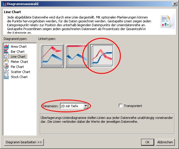

I tried to make my report appear in different diagram types, bar chart works
well in all variants (2D, 2D with depth, 3D).
But if I switch to Line Chart it works only in 2D and 3D.
2D with depth, what I prefer, does not work, it shows 2D instead!?!
(see attachments)
I use Birt 2.0M2 on Eclipse 3.1.0 Build I20050627-1435
Any idea whats wrong?

We have disabled Line 2D with depth, because we can't compute line
intersections well in this mode, so as soon as you get more than one Y
Series and the lines cross, the output looks wrong. For one Y series, it
works fine, but we can't detect how many series the user plans to use. I
propose that you try the 3D Line and give us some feedback on it, so we can
improve it.If you feel 2D with depth is absolutely needed, please file a
bug.
