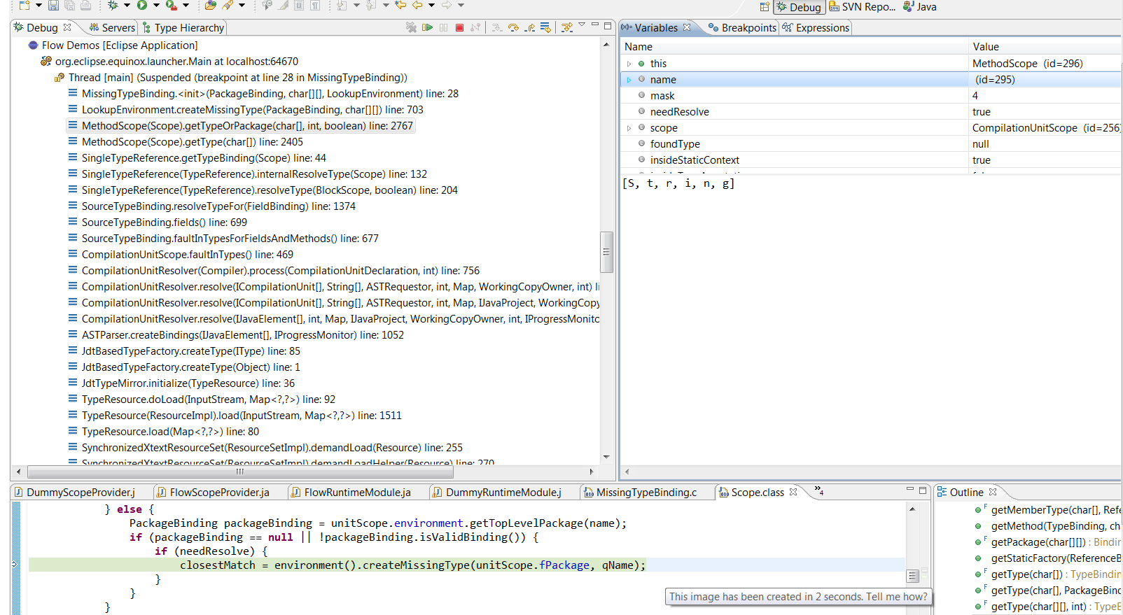

However, when the .foo file is in parent workspace, or deployed in dropins folder, then it can find the ComponentType but navigating to ComponentType.configuration results in JvmVoid as opposed to JvmGenericType.
I suspect this is happening since FooScopeProvider is not delegating to BarScopeProvider. I appreciate any feedback as I am debugging into how to best do this...

Thanks Jan for your feedback. I had a separate chat with Sebastian who pointed out that this is basically a classpath issue. He suggested creating a smarter IJvmTypeProvider which can implicitly add the projects that have the .foo files which contains the ComponentTypes into the classpath.
For a quick test, if I explicitly set the classpath, the validation errors on locating the ComponentType.configuration dissapeared.
IJvmTypeProvider has two concrete implementations: It seems I have to override both ClasspathTypeProvider used in pure runtime, and JdtTypeProvider
