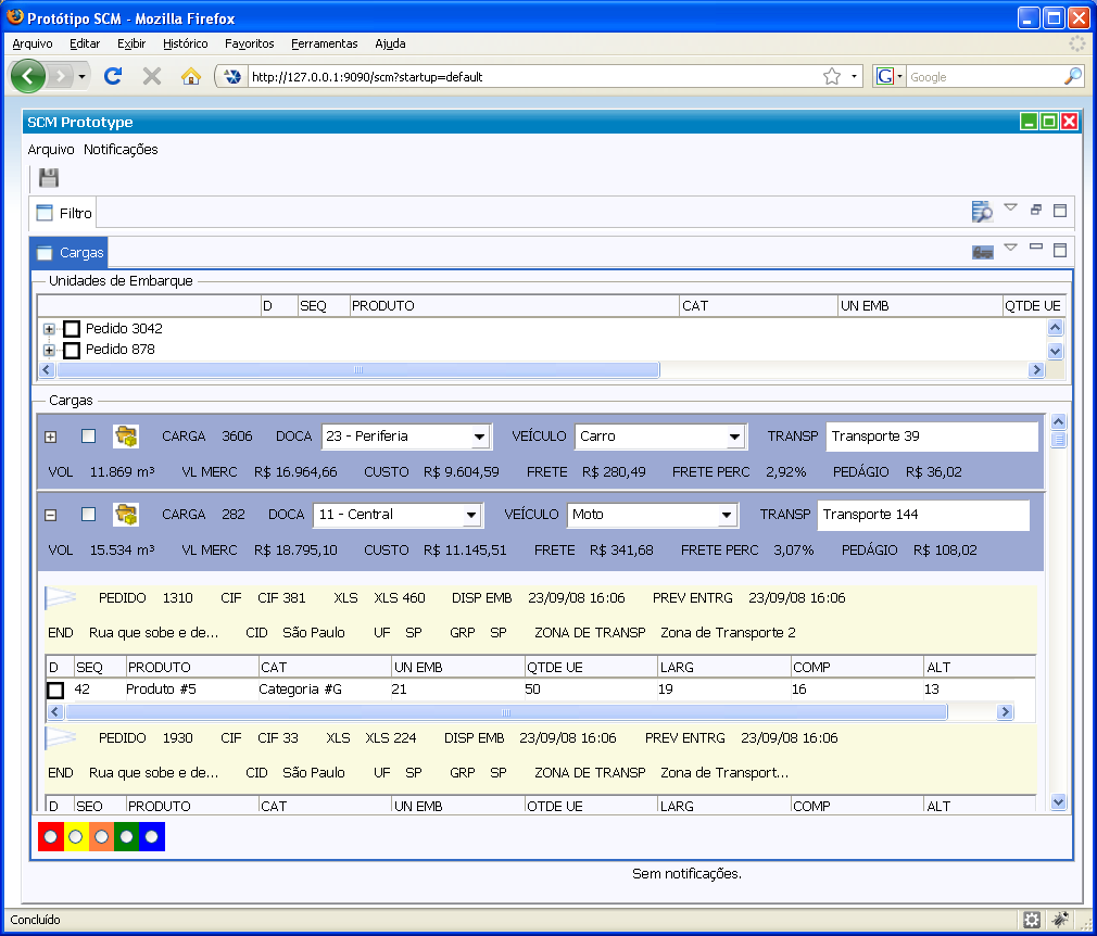

I've been working on a small prototype to evaluate the RAP technology and
was stuck with the memory consumption under IE. My application places quite
a burden on the client as it allocates lots of controls within nested
intermediate panels, but Firefox is able to handle it without problems.
However the application is unusable under IE, which consumes 7 times as much
memory compared to Firefox!
I've been told that IE is a big memory hog compared to other browsers, but
could it be blamed alone for this factor 7 or could also be some issue
related with RAP or qooxdoo? Does anyone know of a javascript benchmark that
shows similar numbers?
Attached you find a screenshot of my application and a short description
below.
Thanks in advance for any help,
Alex
It is a logistics application that consumes a lot of memory because it
allocates a very large number of widgets. The critical structure is some
sort of table where each element (representing a shipment) is a very complex
widget with several labels and subpanels. My table has 100 of such widgets.
Each one of them may be further expanded by the user to display 10 more
subwidgets inside it, and each one of these subwidgets in turn (representing
the orders corresponding to that shipment) is also a very complex widget
with several labels and subpanels! In order to optimize memory consumption,
I create these subwidgets on demand as the user expands one of the parent
widgets.
The application runs well under firefox: it opens up with 38 MB and rises
to 110 MB when I load my table with 100 widgets. From this point, each
subwidget expansion takes up an average of 7 MB.
I can not run such application under IE: it opens up with 59 MB, climbs to
524 MB right away after displaying the table with 100 widgets and each
further subwidget expansion eats up 50 MB!
I don't think this could be caused by a memory leak in qooxdoo, as in my
tests I am only creating new widgets and never disposing them.

That was also my main worry when I started analyzing the memory consumption
of the application. However I found out that it consumes "only" 20 MB on the
server side with a single user. So I think it would be optimistic to say
that it could stand at least 50 simultaneous users on a 2 GB machine, and
our application will typically serve less than 20. Of course I still need to
prove that with JMeter tests, but I was surprised with the memory
consumption on the client side in IE which I didn't expect.

It's not really an SWT table, it's just a composite panel where I keep
stacking my custom controls.

Yes, I agree! I also made this suggestion to change the design, but the
staff that works with user support insisted that the system should stand at
least 100 elements on a single screen. It amazes me how can someone deal
with such a large amount of information, but I was told this system is
typically used by someone who's used to do this task every day.

Yes, that would be great. Basically I have two problems in IE:
- loading a table of 100 elements takes 500 MB,
- each widget expansion takes up an additional of 50 MB.
I also thought about creating a lower panel in order to display a single
element at a time as you suggest. That would solve the second issue once the
qooxdoo guys solve the memory leak issues, but I still need to show the 100
elements in the table as I told you. I could follow your suggestion of
optimizing it further and loading/disposing widgets when the table is
scrolled (still need to investigate the impact of this on the user
experience), but I would like to know what makes my application so memory
consuming under IE compared to Firefox. This is what makes me worried with
the memory consumption of RAP applications in IE.
complex widget with several labels and subpanels. My table has 100 of
such widgets.
(representing the orders corresponding to that shipment) is also a very
complex widget with several labels and subpanels! In order to optimize
memory consumption, I create these subwidgets on demand as the user
expands one of the parent widgets.
rises to 110 MB when I load my table with 100 widgets. From this point,
each subwidget expansion takes up an average of 7 MB.
to
