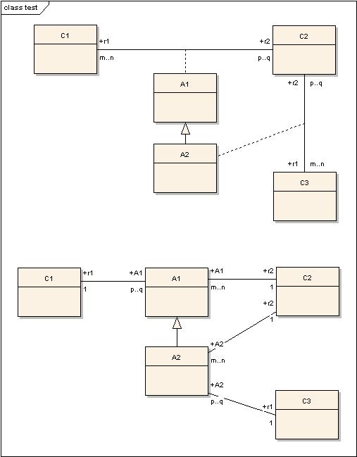

Originally posted by: Ericson_George.EMC.com
More detail on the first suggested solution. The assertion being made is
that the two sets of associated classes in the attached diagram are
equivalent. And, therefore OCL should allow traversal from self, via an
association class to the opposite end class by the general algorithm:
self.<associationClassName>.<oppositeEndRoleName>
Note that this example illustrates the CIM issue that Andy referenced.
George

Re: Traversing associations that own their ends in OCL [message #9713 is a reply to message #9702] Wed, 07 March 2007 18:46 Go to previous messageGo to next message
Originally posted by: maiera.de.ibm.com
Christian,
this is very good information. Thanks much!
However, as I understand it, the proposal basically makes an end owned
by the association appear as if it were a (virtual?) member of the
associated class. Simply using such a virtual member creates an
ambiguity problem (potentially), since the uniqueness of the name of
that end is only guaranteed within the scope of the association, but not
within the scope of the associated class. For ends that are owned by the
associated class, the name of the end is guaranteed to be unique within
that class, that is why the ambiguity problem does not exist in that case.
We need something to disambiguate the end's name in the first case, for
example by inserting the association's name into the OCL statement as an
additional step, as in:
self.<assoc-name>.<far-end-name>
where the context is the class associated at the near end.
If we do it like that, I think the mechanism for inverse
cross-referencing you mentioned could be used to traverse from self to
the association, and then the existing traversal mechanism would be used
to do the second traversal step, i.e. to the associated class at the far
end, since the far end which is owned by the association now is a simple
pointer in the direction of traversal.
Do you see any obstacles with this ?
Andy

>> 2. If so, given the fact that in CIM, the association classes have to
>> own the ends, this essentially prevents us from doing _any_
>> association traversal in CIM user models.
>> 3. If so, can we get an extension in OCL that allows us to do
>> association traversal even when the ends are owned by the association
>> (class) ?
>> One idea on how to address the above mentioned naming ambiguity in
>> such an extension would be to code the traversal in two steps in OCL:
>> First traverse to the association, then to the far end. Alternatively,
>> an OCL operation could be provided that performs the traversal and
>> gets the right scoping arguments to avoid the ambiguity, such as the
>> association class name, or role names of the ends.
>> Andy
Re: Traversing associations that own their ends in OCL [message #11236 is a reply to message #9713] Wed, 07 March 2007 19:15 Go to previous message
Originally posted by: cdamus.ca.ibm.com
Hi, Andy,
That is how the navigation of non-navigable ends works in OCL. The
assumption is that the end name would be unambiguous despite not being in
the namespace of the classifier at that end. This normally isn't a
problem, but the OCL provides no means to disambiguate the reference in
case of a name clash. The OCL also prescribes a means of addressing a
non-navigable end that has no name, by using the name of the classifier at
the other end with an initial lower-case letter.
Association-class navigation should work (at least in parsing) already.
The association class is navigated by the same convention of using its
name with the initial letter lower-cased. Note that the UML support for
OCL (in 1.1 M5) supports this association-class navigation at run-time
only on object models in the UML model (represented using
InstanceSpecifications). It will not work with UML- or EMF-generated
code, as EMF does not have association classes.
Have a look at the AssociationClassTest test case in the
org.eclipse.ocl.uml.test plug-in for examples of the kinds of
association-class navigation expressions that are supported, including
navigation qualified by association end role.
HTH,
Christian
Andreas Maier wrote:
> Christian,
> Andy
