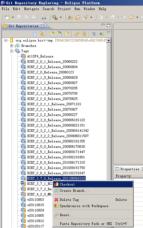

Re: Problems building BIRT 3.7.1 from instructions [message #882647 is a reply to message #882392] Wed, 06 June 2012 19:05 Go to previous messageGo to next message
I believe the error is due to checking out the source from head versus
checking out the 3.7.2 version. I tried it and got the same error as
you. I then switched to the GIT perspective and expanded the Tags tree
under Branches and located the 3.7.2 release tag. I then right clicked
on the release tag and selected the checkout option. After doing this
the source built fine.

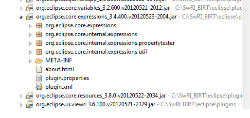

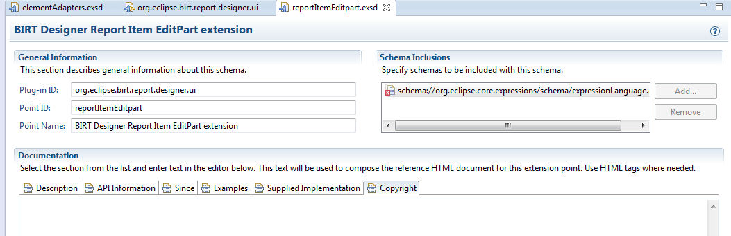

I do have the jar you mentioned org.eclipse.core.expressions_3.4.400.v20120523-2004.jar. And it is in the dependencies of org.eclipse.birt.report.designer.ui . It does not contain a schema. (See image 1. index.php/fa/11520/0/)
So. I edited the jar, added the schema and associated files. Turned off the jarsigner. It finally built without errors. Never mind the errors listed in the Plug in Developer it built cleanly in the Java View.
On to the viewservlets.jar creation.

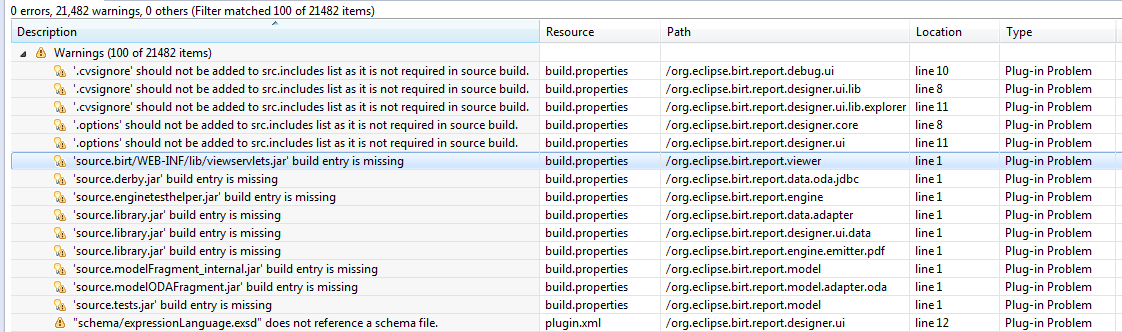

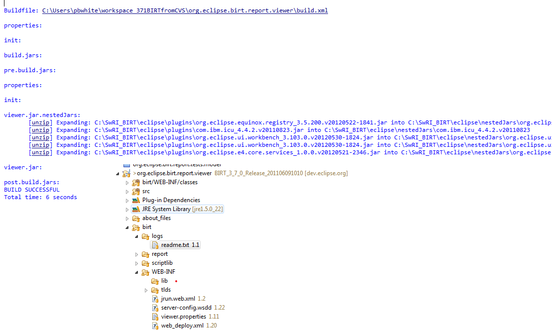

That step failed even though the build indicated success.(see image3 index.php/fa/11522/0/)
When I started digging for problems I saw the following 'source.birt/WEB-INF/lib/viewservlets.jar build entry missing'.(see image 2 index.php/fa/11521/0/).
Ok Great guess this why there is no viewservlets.jar.
