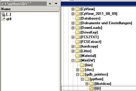

but the script -I am not familiary with python- seems to be ok for me. I attached the folder-view and the dbginit-file, would you be so kind to have a look at it ?

You can start gdb from the command line and enter the commands from gdbinit manually. Then you will see if it works. But it seems your gdb version lacks python support or it cannot find Python on your system. I guess you have to set PYTHONPATH or so (I am not sure, on Linux it works out of the box).
