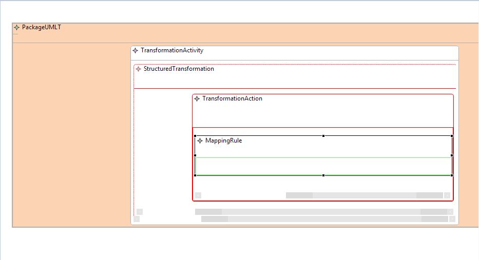

well, thanks for your quick reply...
let me show you the complete scenario:
-Create the diagram
-create the elements inside that diagram.
-saving the diagram should fire the event for looping for all the elements and creating the xml-structured file accordingly.
i have checked the eAllContents method and googled it and indeed that's what i need according to the online documentation!
TreeIterator<EObject> treeIterator = diagram.eAllContents();
but the point is i couldn't retrieve all the elements in my diagram...below is a code snippet i created for retrieving the diagram's elements:
org.eclipse.emf.ecore.resource.Resource diagramResource = umlt.diagram.part.UMLTCreationWizard.getDiagram();
TreeIterator<EObject> treeIterator = diagramResource.getAllContents();
while (treeIterator.hasNext()) {
EObject diagramEl = treeIterator.next();
String name = diagramEl.eClass().getName();
System.out.println("diagramEl.eClass().getName(): " + name);
the expected output was all the elements' names within that diagram, while the current output ist:
diagramEl.eClass().getName(): Diagram
diagramEl.eClass().getName(): DiagramStyle
please have a look over the attached snapshot to get a clearer idea on how to diagram looks like
index.php/fa/7842/0/
thx!
mostafa.
  • Attachment: diagram.JPG

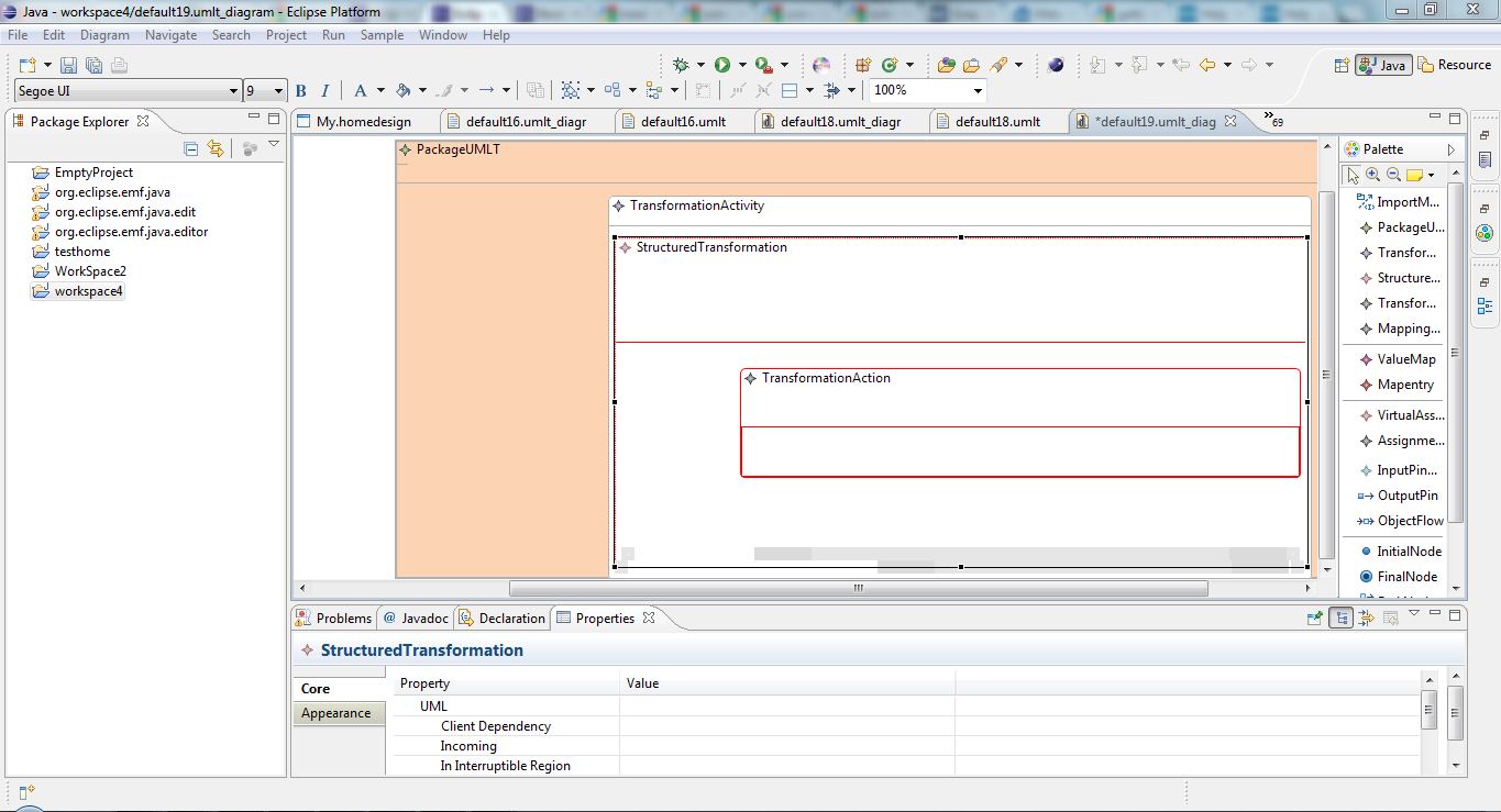

Re: generating xml-structured file beside the generated xmi file [message #845718 is a reply to message #840734] Sun, 15 April 2012 06:44 Go to previous messageGo to next message
Hey Ed,
the model looks like the snap shot below:
index.php/fa/7899/0/
and for the xmi structure:

i've also tried working with some other way for showing the view but it only shows the hierarchy and not all the contents...
So for example if i got a schema like the following:
ModelUMLT --> PackageUMLT --> TransformationActivity --> Structured Transformation Activity --> Mapping Rules --> Assignment Definition
if i got single Assignment Definition the result will be the same as if we got a couple of Assignment Definitions...
  • Attachment: Model.JPG
    (Size: 50.89KB, Downloaded 544 times)
