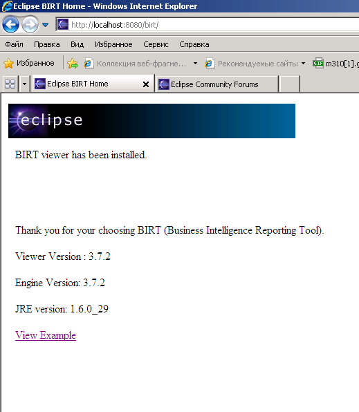

Re: progressive total [message #840410 is a reply to message #840092] Mon, 09 April 2012 23:52 Go to previous messageGo to next message
I think in that side!
But I have error, and in Yours runningsum.rptdesign too.
On run, his fall to exception
Birt ver 3.7.1

Re: progressive total [message #840865 is a reply to message #840410] Tue, 10 April 2012 11:43 Go to previous messageGo to next message
How are you running the report? I just ran it in the designer and in
the deployed viewer on tomcat and it worked fine.
Jason

Re: progressive total [message #843726 is a reply to message #841646] Fri, 13 April 2012 06:01 Go to previous message
Hi, Jason!
I reinstall war file to ver 3.7.2 on GlassFish server, but this dont solve my problem
frameset - work
run - dont work
How to be?
Stack
