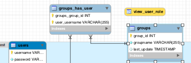

I've got three tables and many to many connections. In my JSF-application I am trying to add users. In my groups-table there is three different groups: admin, customer and user.
What I have done:
After inserting data to jsf-form user clicks save.
ManagedBean called usersController fetches the group (customer-group) from groupsController
usersController ManagedBean creates the new user and save it to the mySQL-db.
PROBLEM is that groups_has_user-table is empty

Only way how I got something to join-table (groups_has_user) is to add group at the same time to groups-table but then there is an own line for every user and I think that it's not the purpose. Many has asked that, but I couldn't figured that out even if I read those. How to avoid inserting data to groups-table in that case? I just want to have three lines of data in groups-table, now and forever, 1 admin,2 customer and 3 user?

  • Attachment: DB.png
    (Size: 21.71KB, Downloaded 1014 times)
