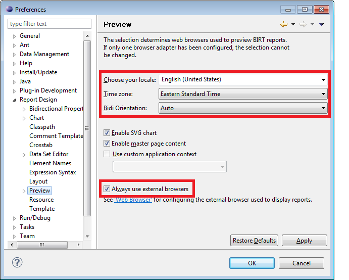

I believe this is correct. One simple test to try is in the preview
options set the locale for testing. See attached screenshot. Also set
Always use external browser and when you preview the report you will see
the url. You can add the date parameter to the url and refresh the
report. This should prevent the parameter box from being displayed.
Jason
Jason
