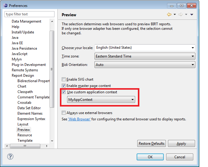

Use the org.eclipse.birt.report.viewer.appcontext extension point to
supply your own appcontext for the designer session. I have attached a
small plugin project that shows a very simplistic implementation. Take a
look at the screen shot to see what preference needs to be set in your
designer to use the plugin once you have it deployed to your designer.

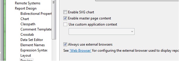

Jason,
Appreciate your quick response.
I encountered your two proposed solutions in previous blogs you have wrote. The option to use remoting is valid but requires a lot of work. The option to use extension point seems simpler to me. I checked the preferences page and the section to set a custom application context is disabled. I have Eclipse 3.7.0 installed (see attached screen shot). Please advise.
Rafi

The box will be enabled once you create the plugin and deploy it to your
designer.
