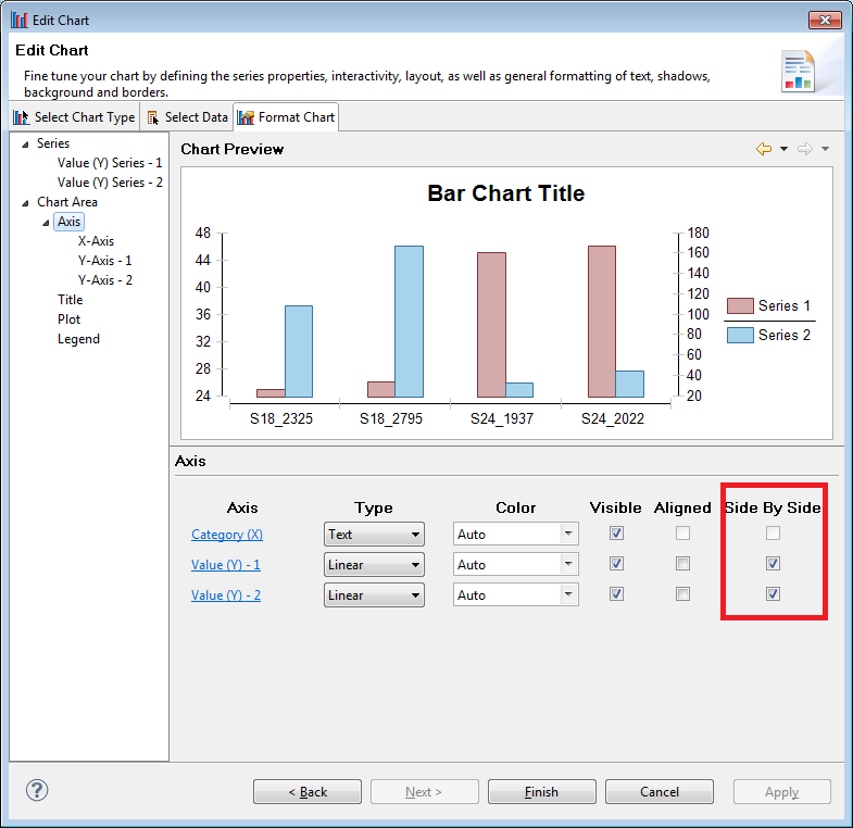

Re: Bar chart with multiple axis [message #832911 is a reply to message #832550] Fri, 30 March 2012 14:46 Go to previous messageGo to next message
If you are doing this in the designer just use the gui. See attached
screenshot.
Jason

Re: Bar chart with multiple axis [message #834663 is a reply to message #832911] Mon, 02 April 2012 04:25 Go to previous messageGo to next message
Unfortunately in my version (2.3.2.r232) the only options available under axis tab are:
- visible
- type
- color
"aligned" and "side by side" options are not available in the GUI
is there any workaround to achieve the same effect?
Thanks again!
Re: Bar chart with multiple axis [message #835717 is a reply to message #834663] Tue, 03 April 2012 11:33 Go to previous message
I do not think 2.3.2 had this feature, but you can check the xml view
and do a search for <SideBySide> in the chart xml.
Jason
