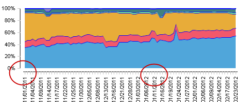

hi,
Again, some stuffs I am trying to solve but not happening.
Like in this chat
1 ) How can I start the charting exactly from (0,0) [Marked in circle.]
2 ) How to remove the small cross line in x-axis?
3 ) Is it possible to bold the axis line?
4 ) Is there way to organize legend? like 2 column in middle in top.
Please help.
Thank you.
  • Attachment: preview.png
    (Size: 15.49KB, Downloaded 174 times)
[Updated on: Thu, 22 March 2012 17:35] by Moderator

1 - You can join the axis by setting the origin in the chart builder,
but the area on the left of the area chart is difficult because that is
the default behavior for that chart type. You can bump it using some
script but it will make the right side off. Take a look at the attached
example.
2 - turn off tick marks on the axis in the chart builder. This is under
gridlines button for the given axis.
3 - See script in second chart in attached example.
4 - use Layout button on the legend in the third tab of the chart wizard.
Jason
