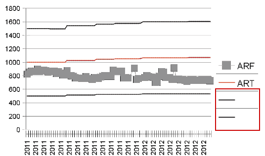

I have a report with empty y-axis series legend. I want to hide it. can anyone please help?

I am attaching two examples. One beforeDrawLegendVis.rptdesign just
shows how to hide the graphic if the label contains no text. This may
work in your case, but if it creates a hole in the legend, meaning you
have values after it you may have to do a bit more scripting. The
second example shows how to remove an entry from the legend without
creating a hole.

hi Jason,
Awesome, Thank you so much, its working perfectly like what i want.
Again, thank you for your time.
